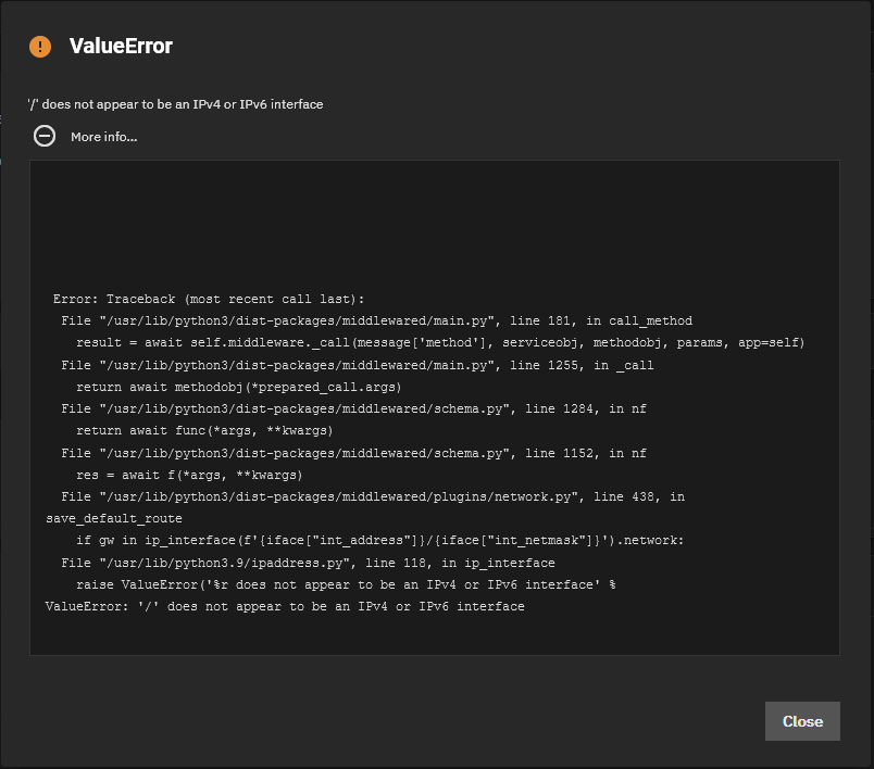

If you try to uncheck DHCP it then asks for a default gateway and then throws this python related error:

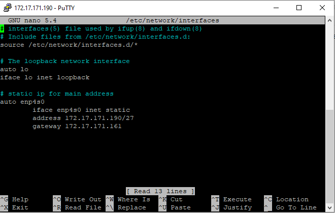

Ok, I was able to set a static IP but not via the web interface. I got it working by editing the /etc/network/interfaces file:
sudo su
nano /etc/network/interfaces
# interfaces(5) file used by ifup(8) and ifdown(8)
# Include files from /etc/network/interfaces.d:
source /etc/network/interfaces.d/*
# The loopback network interface
auto lo
iface lo inet loopback
# static ip for main address
auto enp4s0
iface enp4s0 inet static
address 172.17.171.190/27
gateway 172.17.171.161
Then, for a while I had two IPs showing up in the web interface. I unchecked the DHCP option and got the error I posted above so didn't think the change stuck but after I rebooted the system the DHCP option was unchecked and the static IP was in effect and working.

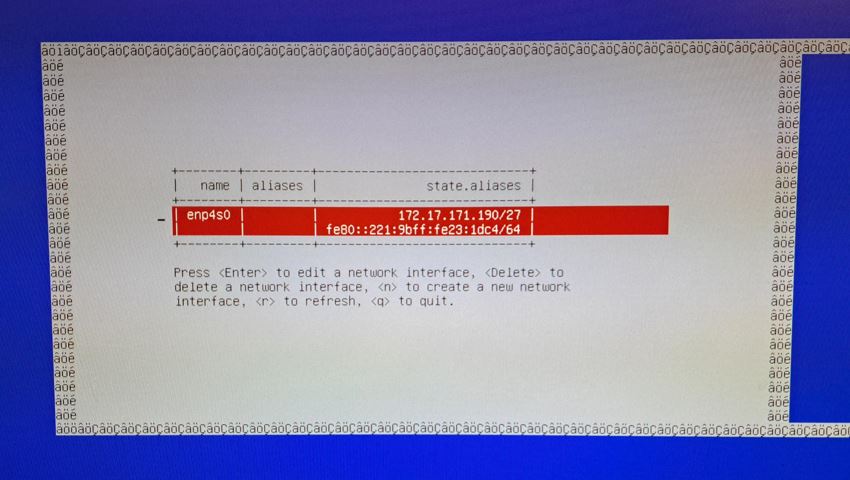

I did try to do it while first installing the system via the installer's CLI and that wasn't working either. I'm wondering if doing that may have caused issues with the system after it was fully installed and up and running?
I chose the option: "Configure Network Interfaces" when installing so I could give it the IP on my /27 network that I wanted it to have but there was no way to enter the IP address. I ended up just letting it use DHCP and then I ran into issues after the install when trying to set it to static via the web interface.

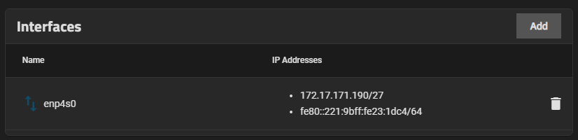

Anything done via the console's netcli should be safe; it's part of the system firmware and has access to the configuration database.
