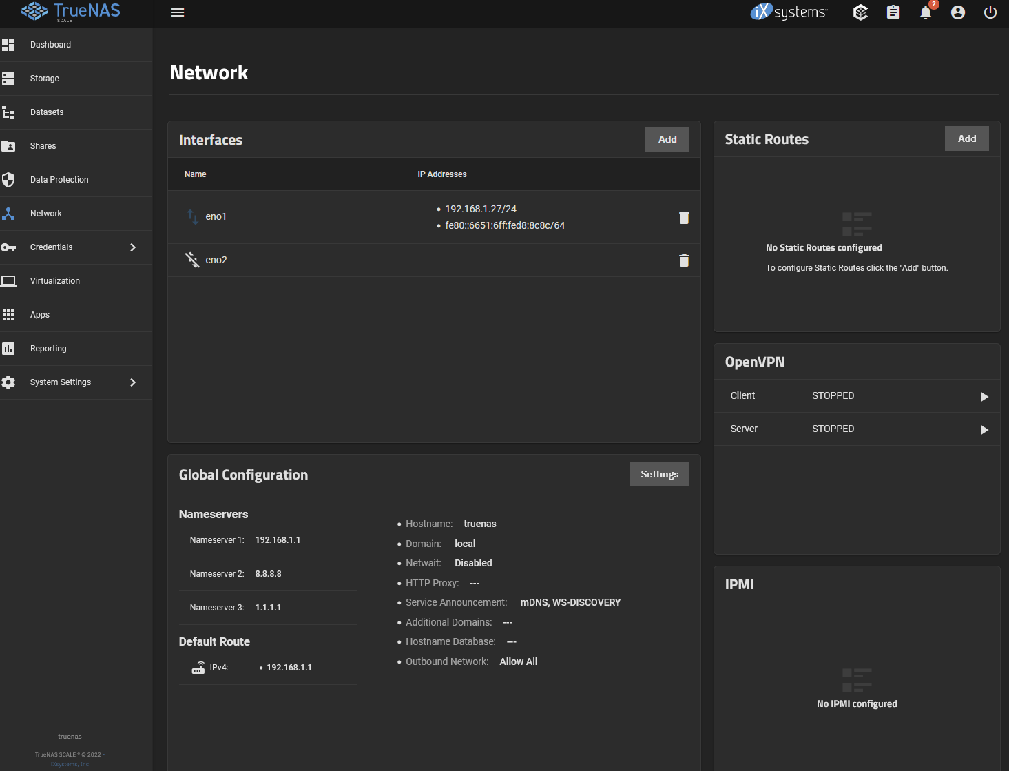

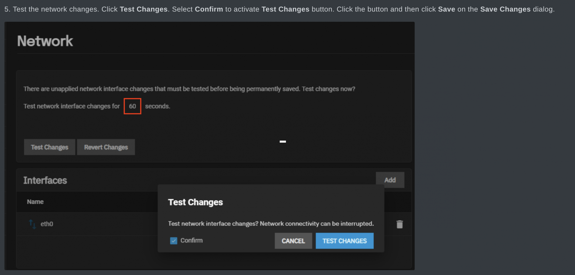

after fresh install of truenas scale and the first thing i tried to do was set a static ip address for my nas server but with GUI but it doesn't seem to work.
i followed the instructions from documentation page but at the point "The system attempts to connect to the new static IP address. If successful the Save Changes widget displays." I tryng to connect the GUI on new ip adress but don't response. I tried several times but it doesn't work.

Does the new static IP address match your network? Did you enter the new address into the address bar of your browser? Have you tried increasing the timeout?

ip from dhcp 192.168.1.27 and I want to use 192.168.1.12
Obviously I have trying to access from browser.

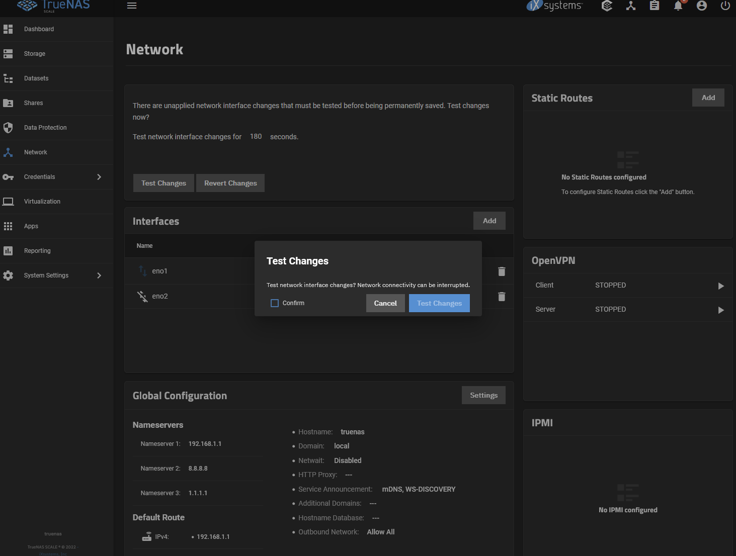

where can I increase timeout?
9,700
Obviously before you click Test Changes...

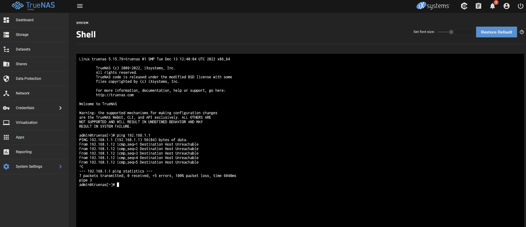

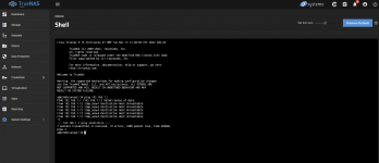

i changed the timeout (the value is not intuitive that it can be changed) and set to 180 and now I can access the GUI on the new ip but and I have validate the changes but after reboot the machine now it's impossible to access to the GUI on new ip.
I have trying to ping my gateway at 192.168.1.1 and is unreachable but I have set gateway.

It doesn't really address your question, but really, it seems that trying to change the network configuration using a service (the web GUI) that has to be accessed through that same network just isn't a very sound plan. The console setup menu really seems like the better way to go.

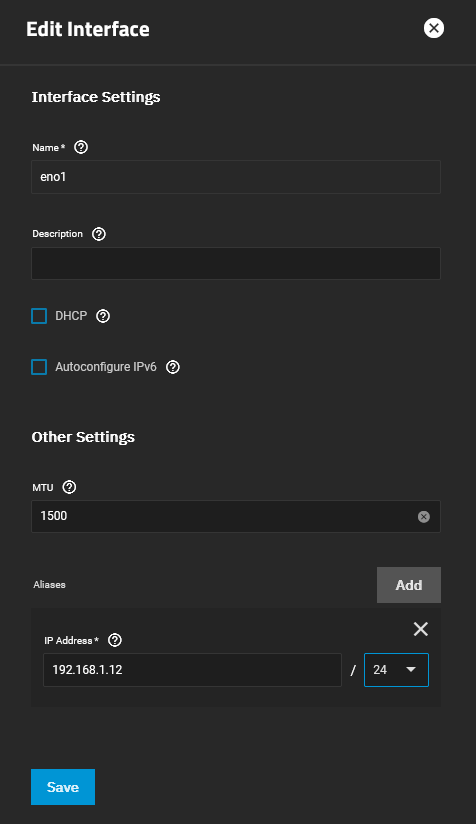

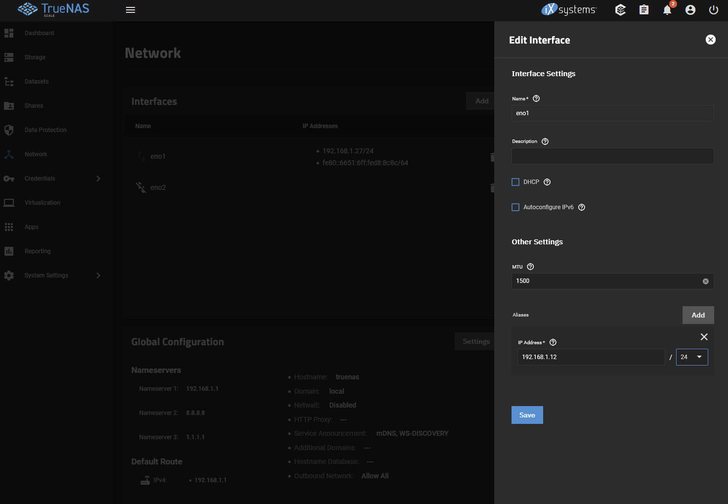

it doesn't work anyway, i tried again from the gui and i have increase the timeout up to 260 seconds but the gui don't response on new ip.

why now truenas don't ping my router?
