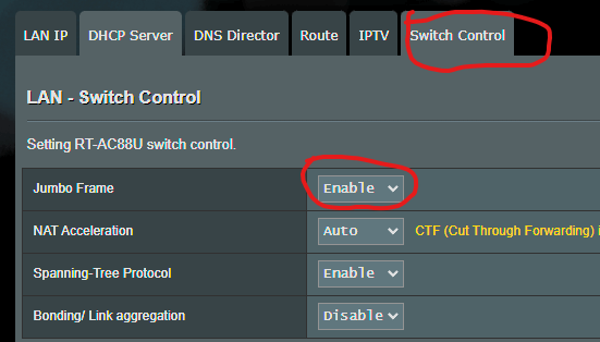

Barmax
Feb 11, 2024
Thank you for the advice! I have an ASUS RT-AC88U. I could not ping or connect using IPV4 after my first reboot after setting up a static IP but my drive mappings still worked.
Enabling Jumbo Frame did the trick. My TrueNAS server is an old Dell T20 using onbboard NIC
