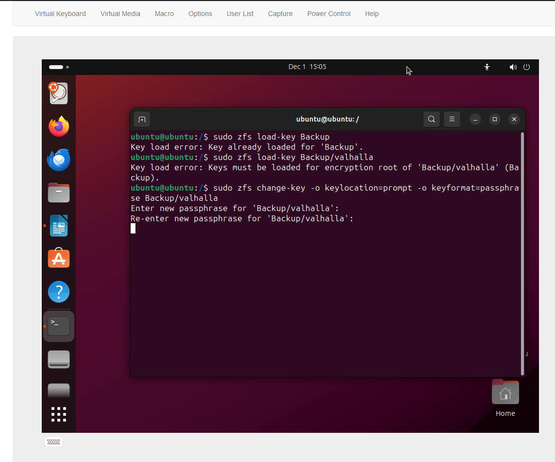

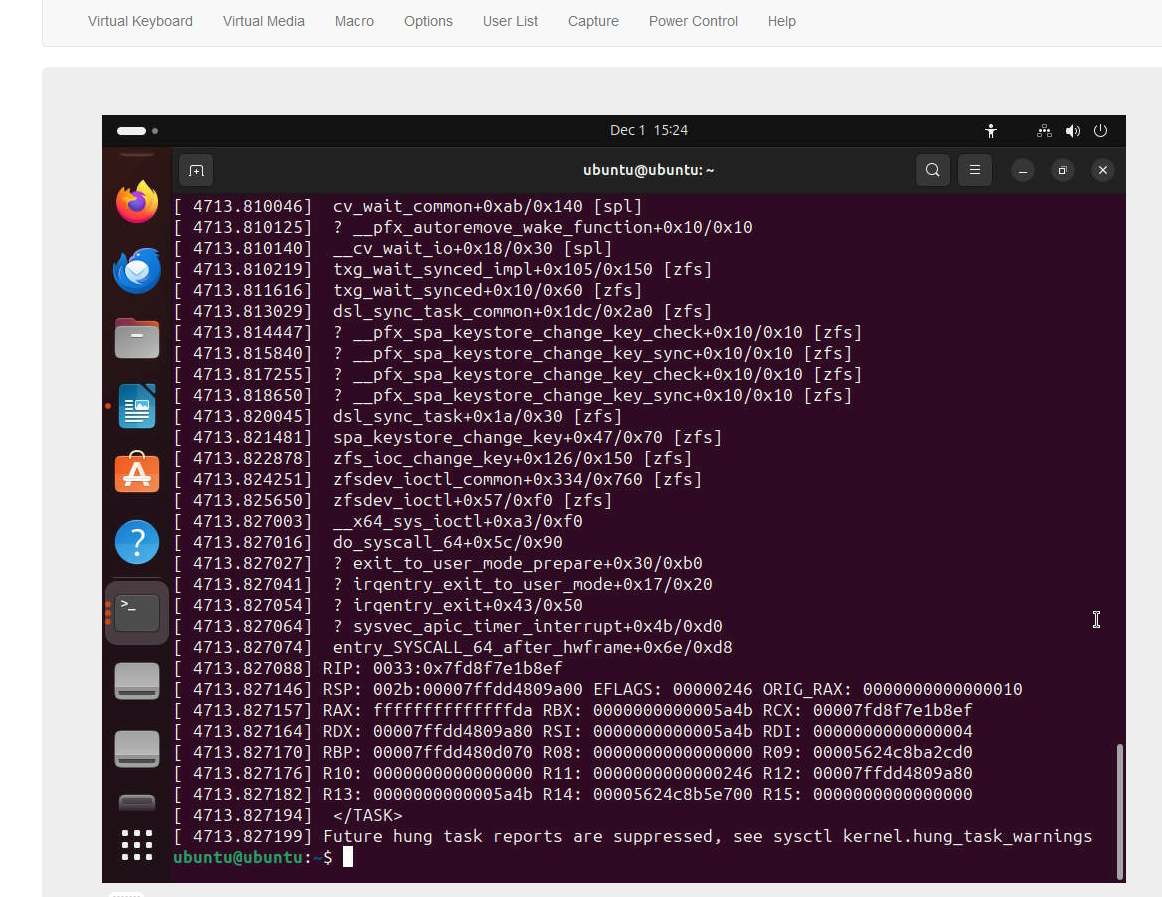

Hold on. Did your original pool also use a "special" vdev and/or metadata vdev?
If it's not due to using any special vdevs on the original pool, and you can't even create a new user key, I'm running out of ideas. This is not looking good.no, it was a single vdev, no ZLOG or Caching or whatsoever. just Nested Datasets and (on the main) two ZVOLs for iSCSI.

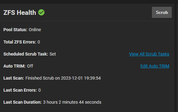

I'm seriously out of ideas.scrub was completed without errors.
