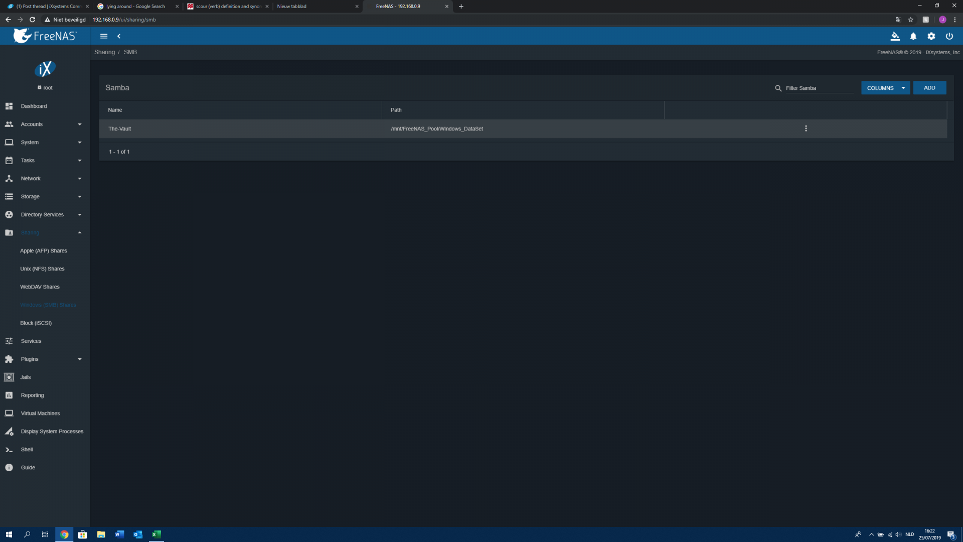

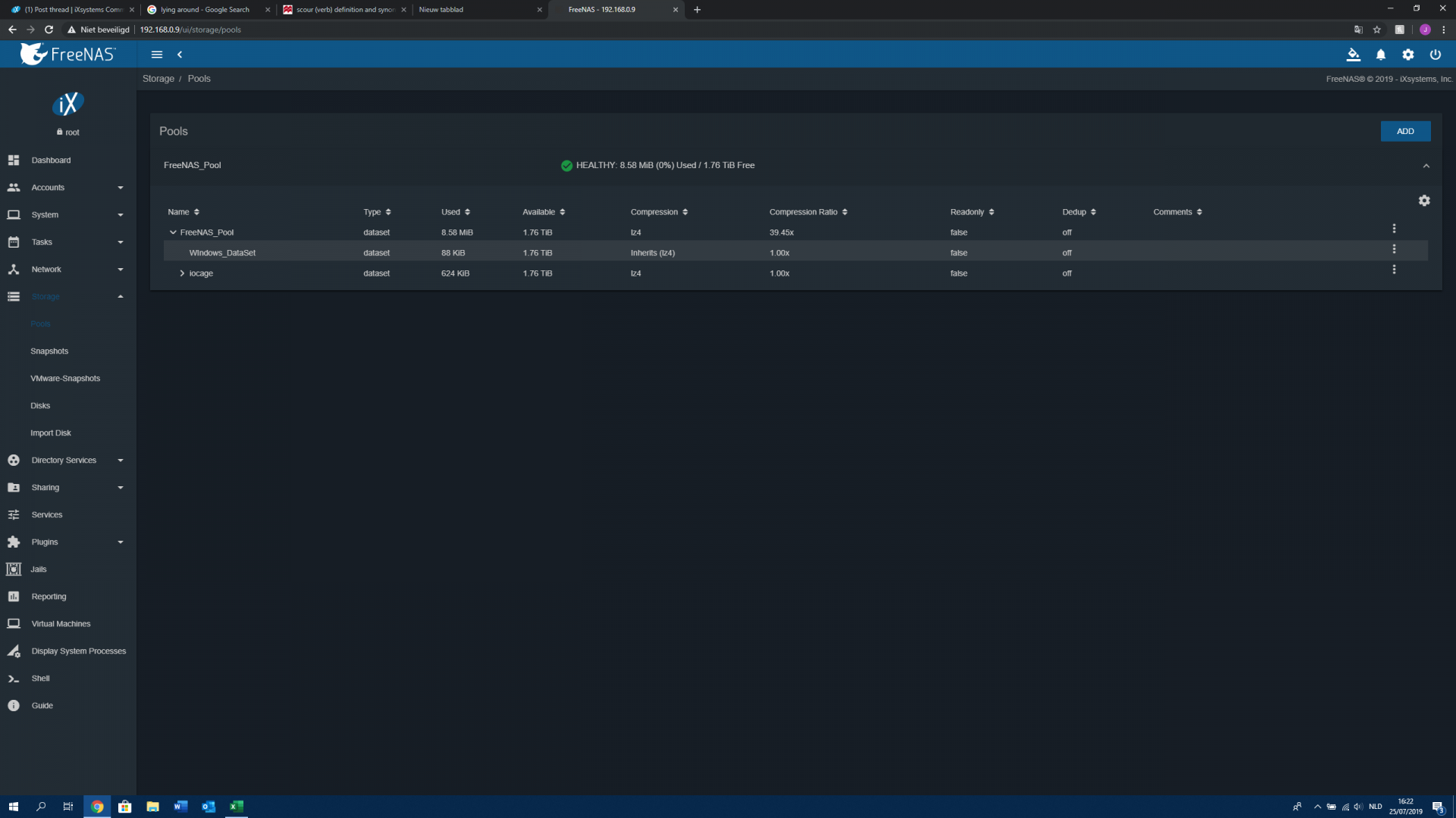

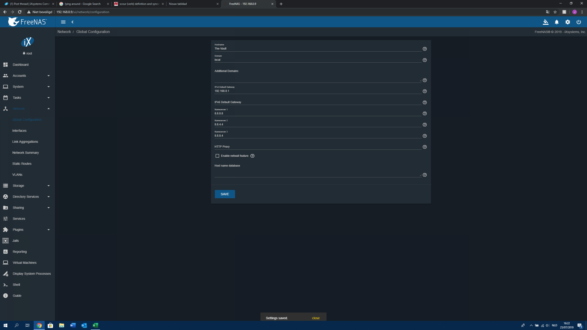

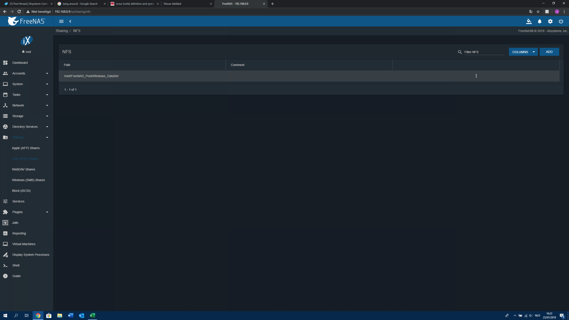

Hello
I had an old laptop lying around and used to install freenas. Everything went fine with setting up untill I tried to share a drive. It just would not show up in windows explorer and even when I ran net use in cmd it can't find it. Wierdly enough, I can ping it throug cmd and if I create a unix share it does show up in the files application of ubuntu. I have been trying to fix this for almost 4 days now and I scoured almost the entire forums of IxSystems and stack overflow, but I can't find a solution. This is my last option. So if anyone can help me with this problem, I would highly apriciate it.
PS: Sorry for my bed Englisch, I am dutch.
Thanks in advance.

Other options are possible but, for windows most people use the SMB sharing.
Jul 25, 2019
3
Thanks for the fast reply, but that is in fact the problem. The service is on but I can't see the share. I can ping it.
Jul 25, 2019
3
It turns out that I needed to enable the SMB v1 support in the settings of the smb service and that I needed to enable some services on the windows 10 side
