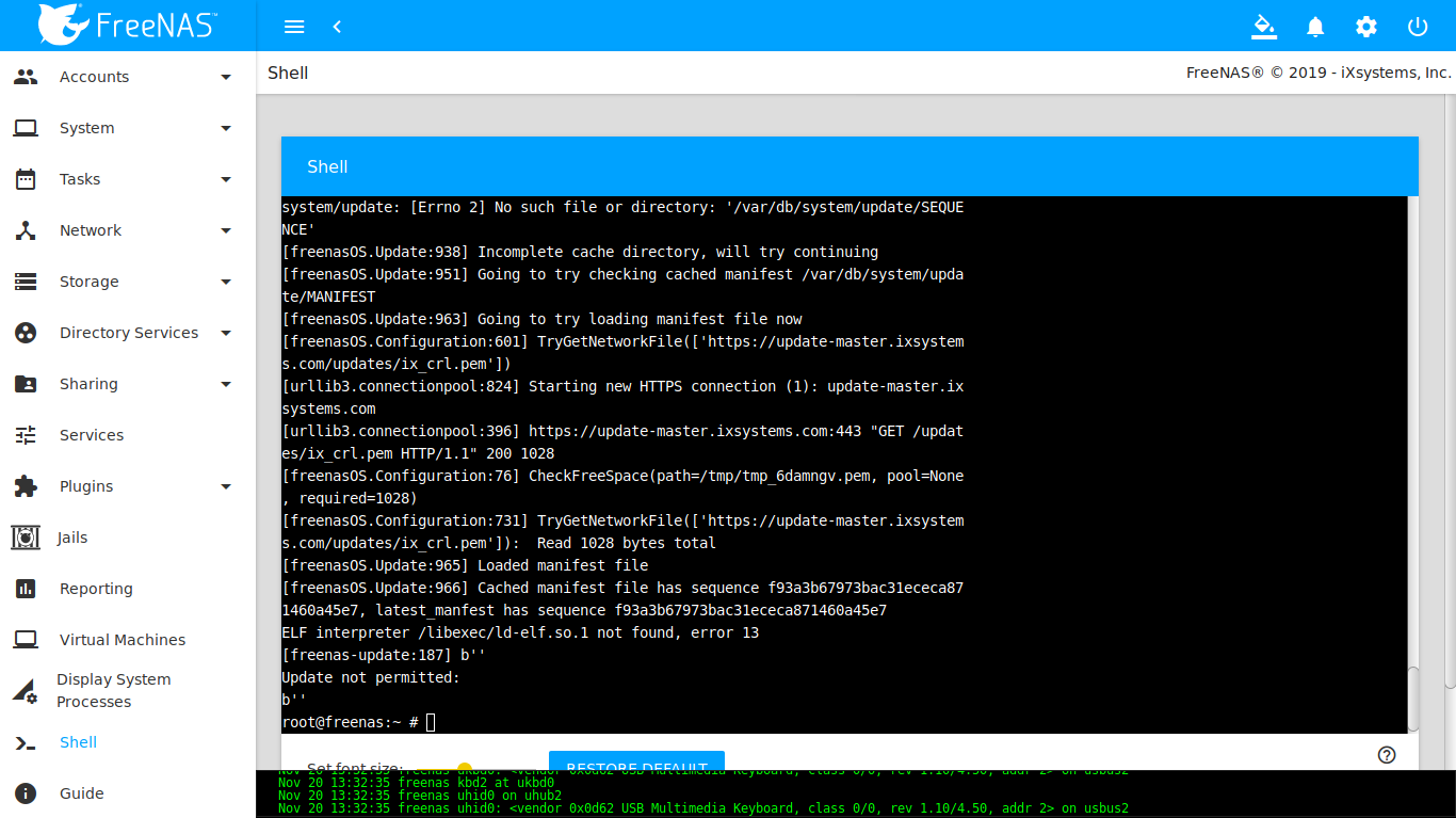

Sparktrician
Oct 8, 2012
11
Thank you for the suggestion, but it did not work.

Fredda
Jul 9, 2019
608
I did not expect that to work, but I was hoping the output could tell a little bit more about what is happening.
Please don't post screenshot of command outputs, copy the text into the post and put it in [code][/code] tags.
From the parts of the output it seems there is something wrong with the filesystem of the FreeNAS system partition.
Do you have an USB stick as a boot drive? Could it be your system drive is full?
Jailer

Fredda
Jul 9, 2019
608
can't get the output of freenas-update into a file. When I run either
freenas-update -v check >> update.txt
or
freenas-update -v check | update.txt
the file update.txt is created but it is empty. I can't copy the output from the shell using Firefox browser either. If you still want the output of freenas-update, and you know how, let me know and I'll do it.
It should work with freenas-update -v check >& update.txt, see here about csh redirection.
Can't you just mark the text in the FreeNAS GUI shell and copy it? But better would probably be to ssh from your client into the server with putty or MobXTerm (I prefer the latter).
Anyway. I'm worried about the error message about the missing /libexec/ld-elf.so.1, this is a fundamental library which should not miss.
Combined with the missing file error at the top of the image it shows, there is something wrong with your system/boot volume.

Sparktrician
Oct 8, 2012
11
Thank you for the command line help.

[urllib3.connectionpool:396] https://update-master.ixsystems.com:443 "GET /updates/ix_crl.pem HTTP/1.1" 200 1028
[freenasOS.Configuration:76] CheckFreeSpace(path=/tmp/tmprjahdeni.pem, pool=None, required=1028)
[freenasOS.Configuration:731] TryGetNetworkFile(['https://update-master.ixsystems.com/updates/ix_crl.pem']):  Read 1028 bytes total
[freenasOS.Configuration:601] TryGetNetworkFile(['https://update-master.ixsystems.com/updates/ix_crl.pem'])
[urllib3.connectionpool:824] Starting new HTTPS connection (1): update-master.ixsystems.com
[freenasOS.Configuration:76] CheckFreeSpace(path=/tmp/tmpgmzjlb24.pem, pool=None, required=1028)
[freenasOS.Update:1620] Could not open sequence file in cache directory /var/db/system/update: [Errno 2] No such file or directory: '/var/db/system/update/SEQUENCE'
[freenasOS.Update:938] Incomplete cache directory, will try continuing
[freenasOS.Update:951] Going to try checking cached manifest /var/db/system/update/MANIFEST
[freenasOS.Update:963] Going to try loading manifest file now
[freenasOS.Configuration:76] CheckFreeSpace(path=/tmp/tmpg7v9pghs.pem, pool=None, required=1028)
[freenasOS.Update:965] Loaded manifest file
[freenasOS.Update:966] Cached manifest file has sequence f93a3b67973bac31ececa871460a45e7, latest_manfest has sequence f93a3b67973bac31ececa871460a45e7
[freenas-update:187] b''
Update not permitted:
b''

notspam
Nov 10, 2019
26
Oki, now I see it.
It was "notspam" that has the boot volume a bit crowded.
Thanks. How do I remove older updates?
Again, here is something not OK with you filesystem. Although this time there is no error regarding the missing missing /libexec/ld-elf.so.1
I think you should file a bug-report.
Menu on the left side, choose:
System > Boot environments
Then left-click on the 3 vertical dots at the far right for the old boot envitonment you want to delete, and chose delete.
Choose activate if you want to boot from that version of FreeNAS.
Don't go too far back in time if you have upgraded the ZFS fileststem.
