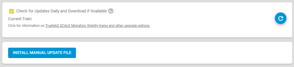

Hello, in new TrueNAS system.
So, i have tried to update the system but it doesn't exist the update buttom.
Only existe the option for update manually, and it doesn't let me update too. Why? because it says this error:
  File "/usr/local/lib/freenasOS/Update.py", line 1258, in ExtractFrozenUpdate
    with tarfile.open(tarball) as tf:
  File "/usr/local/lib/python3.9/tarfile.py", line 1616, in open
    raise ReadError("file could not be opened successfully")
tarfile.ReadError: file could not be opened successfully

save your config
download the ISO of the version you want, put it on some kind of boot media and boot to it, then install over the top of your current install.
If it picks up the current install, you may just be fine with no further action, otherwise, restore your config at the end.

Ty i gonna try it.
but why i doenst still having the buttons that are not on the update panel, it could be a bad installation in first?
9,703
That's the assumption... something not right with one or more of the files in the OS.

I just reinstall the system an all work correctly, it could be for two reasons, first installation was in a virtual machine with limited storage or a bad installation process. Second reason could be for the second installation i do in a real machine i have and it work correctly in first look

Under-resourcing your virtualized NAS is a good way to cause things not to work properly, and modern TrueNAS Core has a 16GB minimum memory requirement, and had 8GB before that. If you were trying to run with less than 8GB RAM, for example, the modern middleware and ZFS are known to be problematic because they are, well, fat.

for the test the 8gb go well, but yeah, now i installed it in better real machine and works better than the VM
