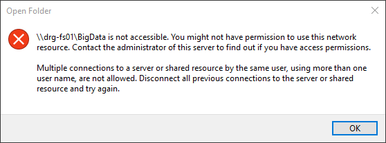

I just upgraded to version 12 - katastrophy. Cannot access my shares anymore at all.
I had my shares set up but suddenly, I receive permission denied no matter what I do.

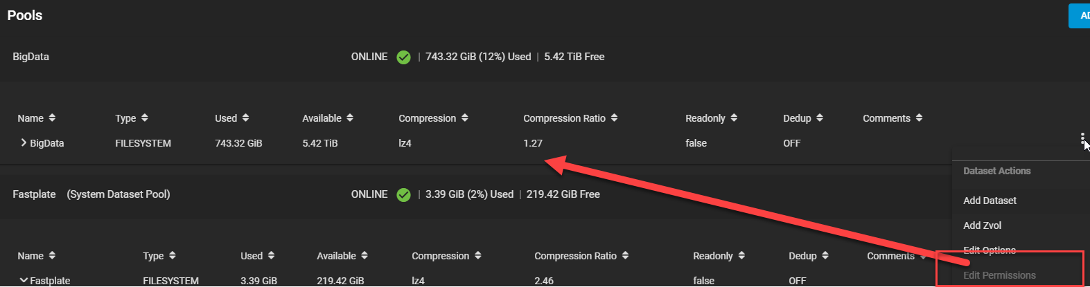

1. All my data is in the root of the pool. With version 12, this is not suggested anymore. One should create a subdataset. Settings for permissions are greyed out. So how will I be able to access my old data and possibly transfer it to a new pool?

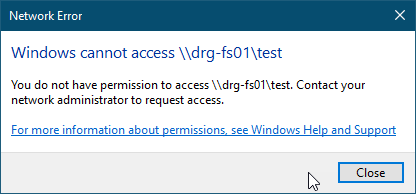

2. Due to beeing unable to change permissions on my existing dataset, I created a sub dataset for testing. I am able to set permissions on that but no matter what I do, it wont work.
Steps to reproduce:
Step 1: Create an account and set password

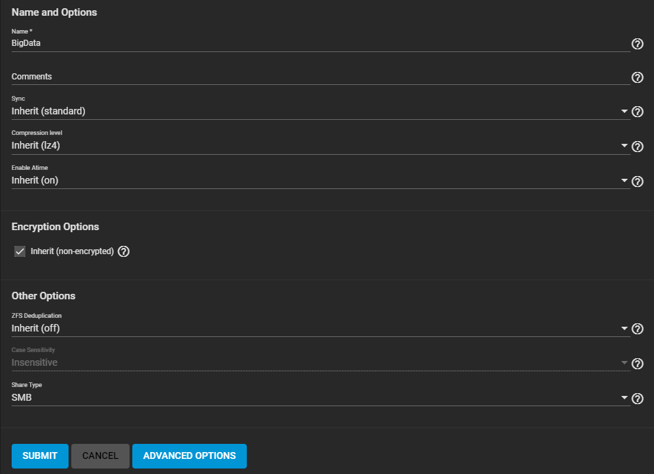

Step 2: Create Sub Dataset with share type smb

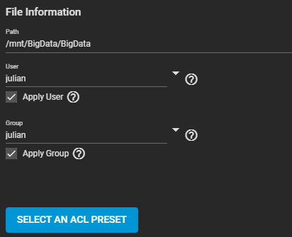

Step 3: Set dataset permissions in pool

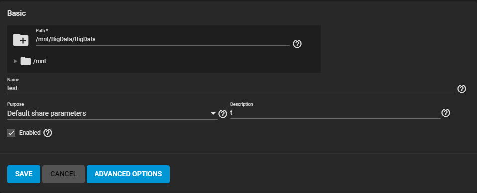

Step 4: Create share on dataset

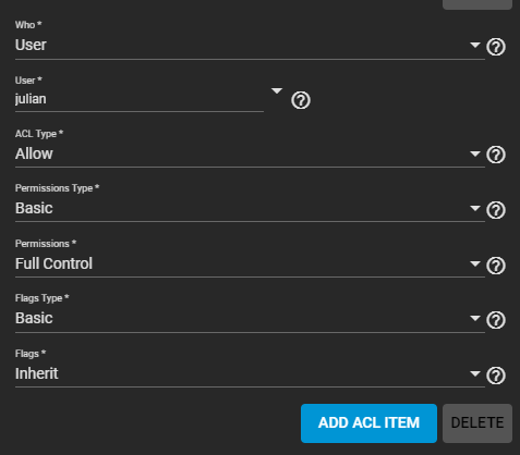

Step 5: Set permissions on share (Edit File System ACL)

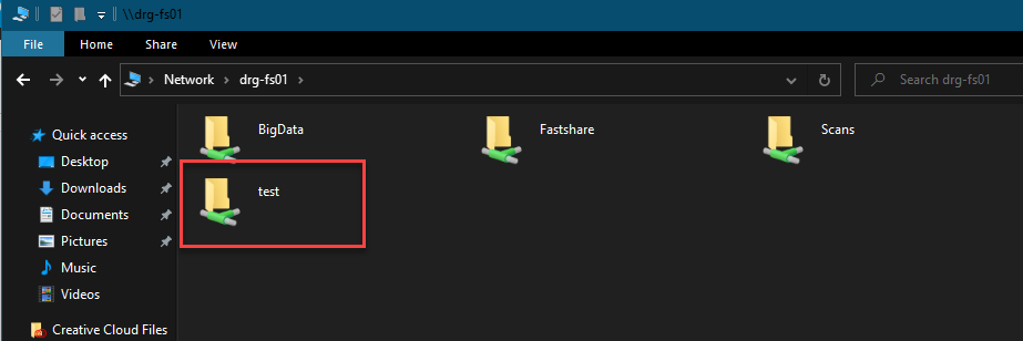

Step 6: Try to authenticate to share:
Trying with guest access enabled:
HerrB
Dec 29, 2020
4
Update. accessing is possible now. apparently was an issue with Windows.
Now the prime question: all my data is in mnt/BigData which is inaccessible. How do I move it to mnt/BigData/BigData?

/mnt/BigData shouldn't have been made inaccessible by upgrade unless the "root" account was being used to access the SMB server? What are the permissions on /mnt/BigData and /mnt/BigData/BigData? (use "getfacl <path>")
HerrB
Dec 29, 2020
4
apparently, the root account was beeing used to access the server
@rjkbj I have been able restore my files with an ssh shell.
