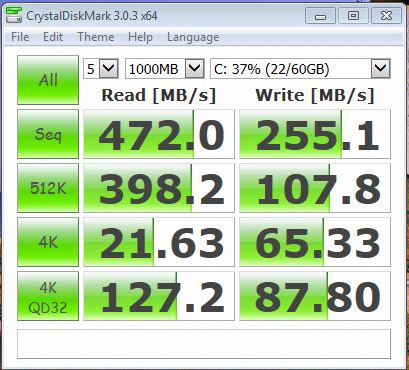

So I just ran my benchmarks again without the PERC card and it's night a day difference. First of all the system boots up without issue, and it boots up fast. The old Crucial M4 drives are not super high speed compared to today's drives but they do a fair job. I think that the write tests would have been faster if I had done a little garbage collection before I ran the test.
Of course is better your card was doing you no good. You saw mine with a good card , aren't they much better ? But now you have no redundancy at all. And this means not just one machine , this means (since it's hypervisor) you will pull the rug under multiple machine when SSD pops. It's really up to you and your needs of reliability.
Oh and I wound suggest using AS SSD along with crystalmark. AS SSD will give you IOPS and MB in the same test. I found these 2 to be the most usefull.
ATTO I don't use much cause compressible benchmark - you ssd will show write 500 MB's but actually when you copy a movie will write with 100MB/s. So uncompresible data benchmark will really show what the drive actually capable of.

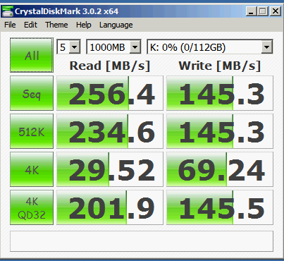

SATA2 subject: Keep in mind that SATA3 will help when you exceed 270 MB read or write speed , which will happened on large sequential reads. Samsung PRO on SATA2 might feel faster than you current SSD on SATA3. Let me find a crystal mark on my Samsung PRO connected to SATA2 so you can see that exceeds speed and iops on everything but peak sequential speed.
P.S I couldn't find a Samsung pro on sata2 bench. But I'll show you SATA2 on Intel S3500, which is much slower and smaller -120GB drive , but still faster than what you have except the peak sequential read. This being SATA2 will run OS snappier than slower SSD on sata3 I believe.

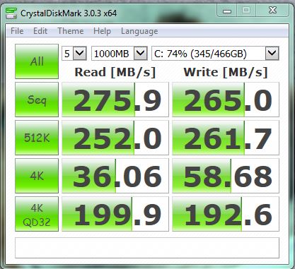

Here is my Samsung 850 EVO on my SATA II connection. I'd buy the Pro version because of the 10 year warranty because I feel like a 1TB drive would easily last that long as a main drive for a personal computer.
There you go. See your 4Kq32 are almost 3 time faster that your crucial on sata3. I have one EVO 256GB in my old laptop sata2.
