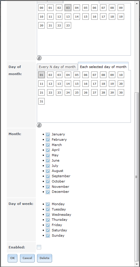

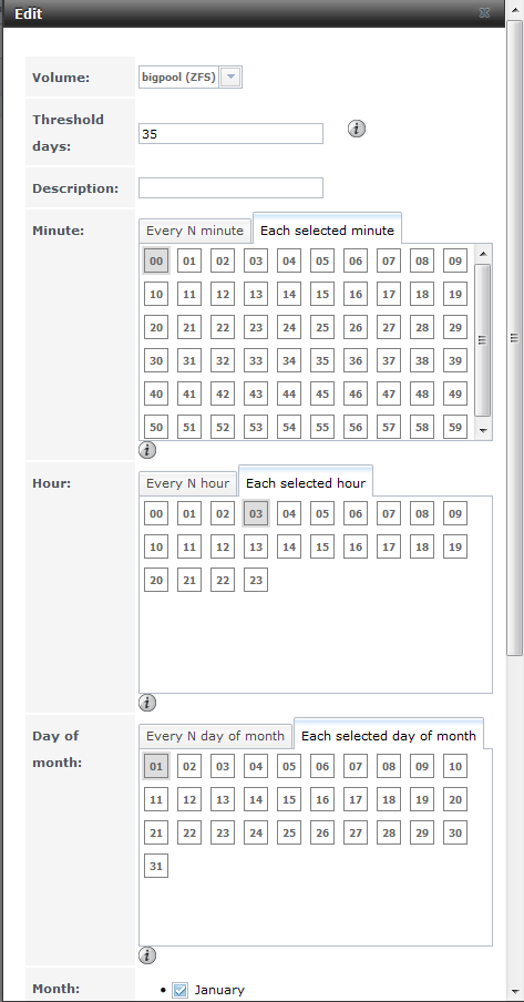

Let me ask you something unrelated I sure you know the answer , but for me it's kind of escaping the common sense and I don't get it:
If you want to setup you freenas to do scrub on 1st day every month at 3:00 am no matter what, is this how you set it up(see pics) ?
What is the relationship with the threshold value ?!

From the user guide: Number of days since the last scrub completed before the next scrub can occur, regardless of the calendar schedule; the default is a multiple of 7 which should ensure that the scrub always occurs on the same day of the week.
The threshold value would need to be set to 28 to take into account 28 days in February if you wanted it to take place on the first of every month regardless of the day it falls on. That is not how most people would prefer it though, most would prefer to see a scrub done on say only a Sunday morning, which is how mine is setup.

I read the manual I of course but.. Let use my case with the settings I show you. Which setting has higher priority "threshold" or what I set in calendar ?
Let's say I ran the Scrub manually on first of a month. Then I "enable" the scrub schedule as set above in pictures with threshold set to 35 is that mean that after 30 days it won't start automatically despite it's set in the calendar cause it has been ran 31 days ago ?

What I don't understand is the purpose of the threshold in a relation with the schedule:
Is it to prevent from scrub from starting too often, or to actually start it if threshold was exceed without scrub ?

If you wanted to set a schedule of every 4th Thursday, it'd make more sense. If you just want on the first of the month, then it doesn't really make much sense.

Threshold has the higher priority.
Yes and I would expect the next run to be the first of the following month, in essence you are skipping every other month.
It's so you can setup a scrub to occur on a specific day of the week but skip 35 days, basically once a month. If you set it up to 14 days and every Sunday, every day, every 3:00AM, then it would run every 2 weeks on Sunday at 3:00 AM.

Also I didn't explain it well but you could set Threshold to a value of 1 if you like and then set your other parameters to have it occur only on the first of the month. So long as Threshold is less than the number of days in a month it would do what you desire.
Right , but the question is will it affect , like stop my set schedule on 1st from running just because threshold is high ?!
YES

I suspect you would perform a scrub every other month. Set the Threshold to 28 or less.
I think I start getting it. So in my case I have to set the threshold to anything less than 28 days and that's how my 1st of the month schedule will not be prevented from running , right ?
Yes. Set it for 28 or less. Think of it this way, if you ran a scrub on February 1st, then 28 days later you can run a scrub again if you like but if it were 27 days or less, the scrub would be prevented from running. Since March 1st is 29 days since the last scrub, it would be permitted to run.
There are a lot of possibilities on how to configure the scrubbing some once you know what you want to do, it's not too hard to figure out what the settings need to be.

You might want to consider setting it to 14. Ie it's the minimum amount of time between scrubs.
This means if you change your scrub day from 1st to 15th, you won't have to wait 45 days for the next scrub.

I think I got it almost. So it should matter if I set threshold for 2 days or 20 days in my case , right ? It's still less than 28.
I just don't what this threshold to start scrubbing on it's own when it's value was exceeded. Like the setting in freenas where you set a threshold for boot drive scrub, and if it's set to 35days , it will start automatically as soon as you exceed the 35 days no matter what. You know what I mean ?
