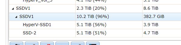

If that's the case, it looks like that volume has one Dataset and two 5TB zvols for the iSCSI connections:
Here's what I would like to do:
1. create a new 1GB zvol for the Hyper-V witness
2. get rid of SSD-2 (there is no data on it now)
3. extend HyperV-SSD1 to fill the volume (except for the witness disk above)
4. add 24 more 1TB SSDs and extend the size of the SSDV1 volume and also the HyperV-SSD1 zvol so we max out that zvol (actually just found this - http://doc.freenas.org/9.10/sharing.html#growing-luns). Is there a reason that the zvol can't use up more than 80% of the volume (per the link)?
5. is there a way to upgrade to larger 2TB drives?
Does all this seem doable? If I understand correctly, I should be able to extend the volume with the Volume Manager by extending the current volume with pairs of mirrors until I use up all of the new drives. To extend the zvol I just update the size in the GUI and then use the command-line to update the size of the associated extent. Does this all sound doable while not losing any data that already exists in HyperV-SSD1 (yes, I will have it backed up)?
