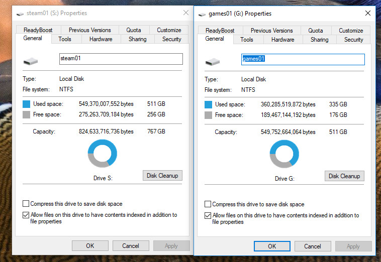

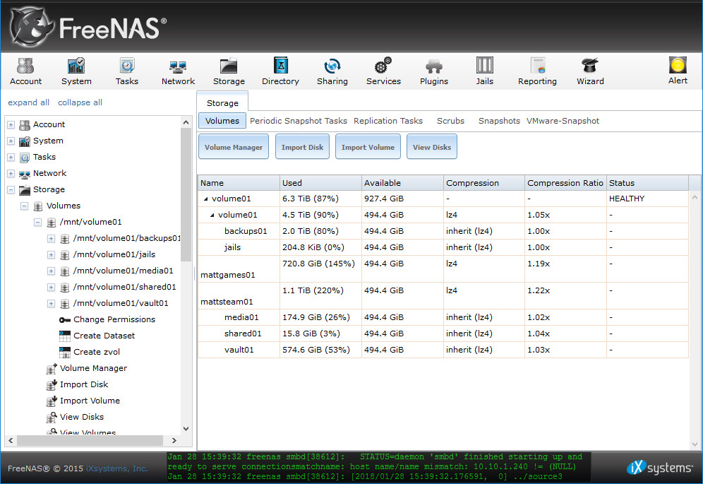

I want to set up a iCSI drive to hold my steam library. I set up a 1TiB iscsi drive through the wizard and when I was done setting it up the initial size of the zvol was about 300KiB, So I figured it would dynamically grow as I added files. So I started copying the 900GB of data to the iscsi drive. But it stopped near the end with a write error. I go to FreeNAS to check and FreeNAS says my volume is over 96% full. I had 2.3TiB of space available when I started all this. I should have enough room to make a 1TiB drive. I checked the zvol usage and it was using 1.7TiB, It doubled the size of the data....
So I deleted it and started over. I made another iSCSI drive manually following the FreeNAS guide. Now the initial zvol size was 1TiB. I then made a 768GB partition on that 1TB drive so that the drive will never be more than 75% full. (now I am referring to the iSCSI drive in windows, not the zfs volume). So I re-downloaded my steam library and windows says it is using 511GB of space on the drive. But now that initial 1TiB is at 1.1TiB in FreeNAS. Again it doubled the space used and it is growing beyond the 1TiB size.
I also made a 512GiB iSCSI drive for other games, and that one is having the same issue. Windows says the other games are using 335GB whereas FreeNAS is saying it is using 720GiB
I know GB and GiB are not the same, but 1GiB is not double 1GB..... What is going on. Doubling the space is not at all efficient.

I posted some screenshots if they help.

For the second, check ZVOL block size you are using to back your iSCSI disk. Your 8-wide RAIDZ2 can be space-efficient only when storing large blocks of data (at least 32KB or more), and your old FreeNAS 9.3 may not be clever enough to increase that block size automatically. Trying to store on that RAIDZ2 pool ZVOLs with default 8KB can quite likely result in double space usage.

You shouldn't be using RAIDZ with block storage at all, because RAIDZ uses a variable amount of parity to protect your data depending on the block size, and this can cause excessive waste. It is totally possible to engineer a situation where your parity uses several times as much space as the data it is protecting. Performance will slowly degrade over time if your pool is more than 50% full, as well.
https://extranet.www.sol.net/files/freenas/fragmentation/delphix-small.png
Because you've got an 8-wide Z2, your optimal block size is six drives wide.
https://extranet.www.sol.net/files/freenas/fragmentation/RAIDZ-small.png
The only case where allocation happens optimally is where you have a block size of 6 * your sector size, or some multiple thereof. So if your ashift=9, then that's a 3072 byte block, or if ashift=12, then 24576 bytes. These are not natural sizes. You only get the natural sizes if you follow the old power rules for the number of disks in a pool (RAIDZ2 = 6 or 10 disks, etc).
So then as an example of how this goes awry, if your ashift=9 and you have a zvol volblocksize of 4K, you need to allocate an (optimal) 3072 byte block on eight sectors, but then you have a leftover of two 512-byte sectors, which needs to be protected by parity, so that's three sectors, but ZFS won't allocate odd numbers, so that's four sectors, so you're using twelve total sectors to write that 4K block, or 50% overhead. If your ashift=9 and a zvol of 8K, that's two optimal blocks on sixteen sectors with a leftover of four 512-byte sectors, plus parity/pad, six more sectors, so that's twenty two sectors to write that 8K block, or 38% overhead.
But it all goes to total heck with ashift=12 (4K sectors). The most obvious one is where you have a 4K zvol volblocksize and you store a 4K block. You need a 4K parity to protect that, so you're instantly at 100% overhead. If you do that on RAIDZ3, then you actually need 3 * 4K parity to protect it, so 300% overhead. So you go to larger volblocksize. So the 8K zvol volblocksize seems like it might work out better, but in reality you need two sectors for data, one for parity, and then one for pad, so you're still at the 100% overhead. You actually have to get up into larger volblocksizes and design them in concert with your pool in order to have a chance at a more optimal configuration. As you raise the volblocksize, you will approach a more optimal situation, but not actually reach it.
But even then, this is sort of screwed up because with the introduction of ZFS compression, things don't always work the way you might think. You can actually get a block compressed down by quite a bit, and that throws all this off. You're more likely to get compression with a larger block. So the generalized answer to your query is to use a larger volblocksize and turn on compression.
This isn't the trite problem that you'd like to think it is. And I've probably made some mistakes because I'm only at two coffees this morning.
