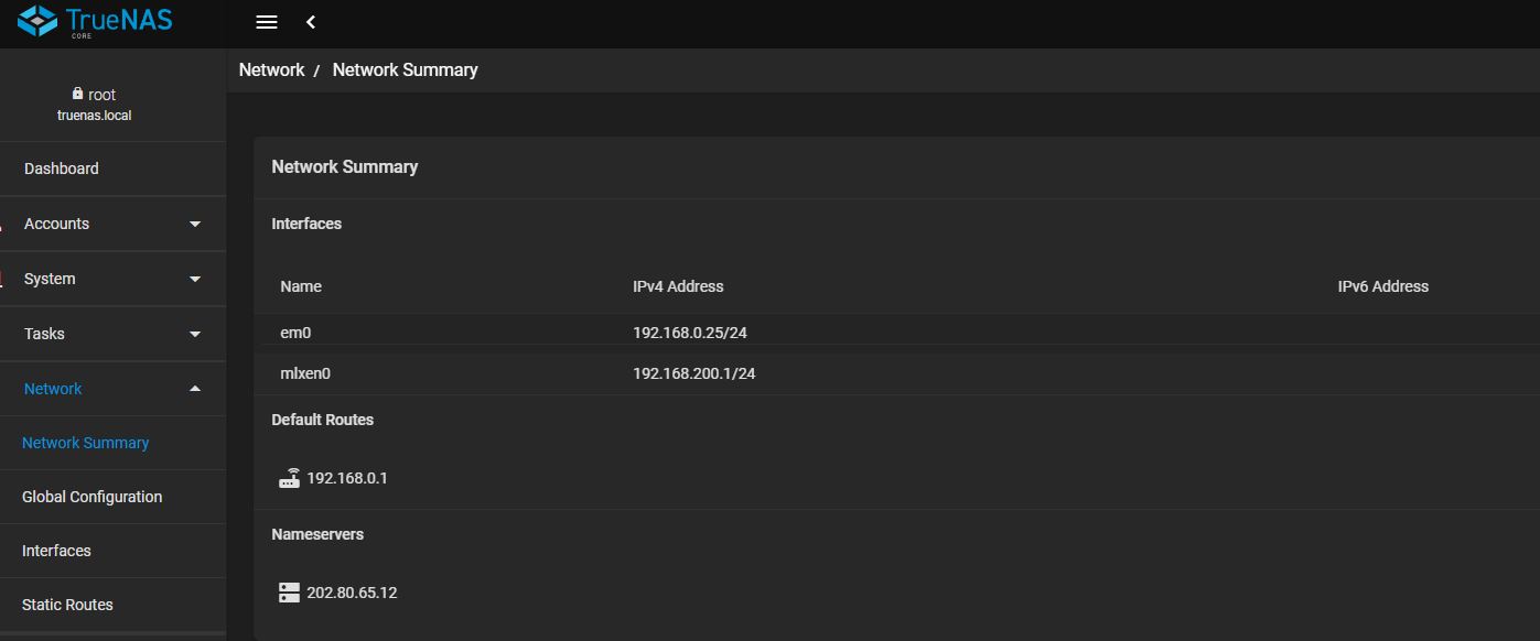

No, I meant, please provide a screenshot of Network->Network Summary. Given that you've multiple interfaces, that explains the lack of a bridge interface, which is required for the Plex plugin to use DHCP instead of NAT. For your plugin, please provide the output of iocage get all plex.
Sabot68
Oct 31, 2021
15
Hi Samuel,
here is a screen shot of the Network Summery page

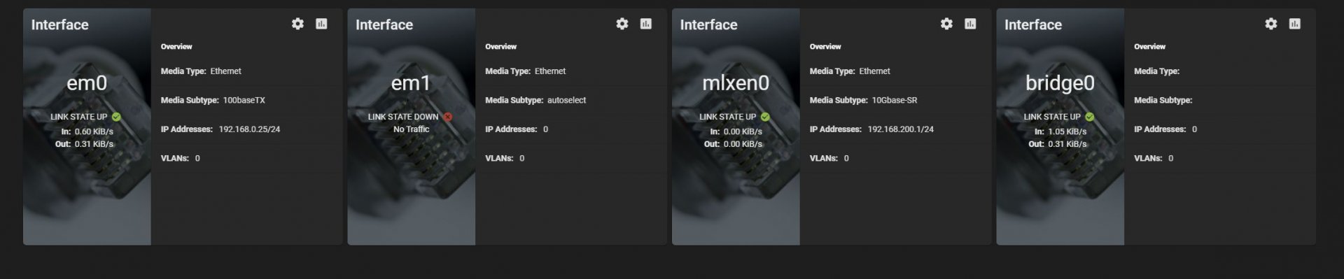

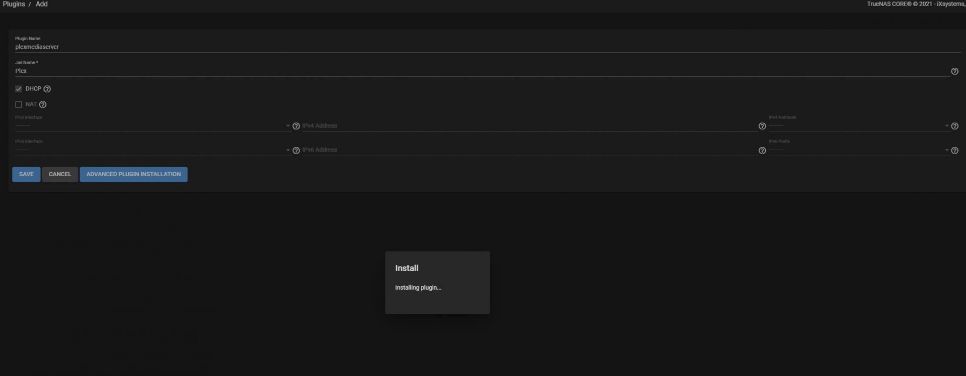

Sabot68
Oct 31, 2021
15
ok so I tried the ifconfig destroy bridge0 command and the system says bridge0 did not exist, continued with your instructions, created a bridge on emo, continued to install plex plug in and it stalls on the installing plex dialogue box
here is a screen grab of my dashboard showing link states...
Thanks for you help so far.

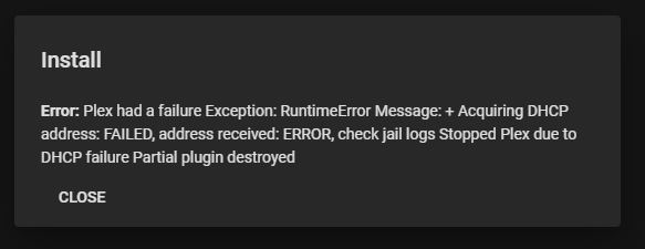

Sabot68
Oct 31, 2021
15
update, not sure what i changed, i didn't think i had changed anything but now the install is not stalling but back to where i was earlier, gets to about 50% then a dhcp error:
Dont know how to access the jail logs.

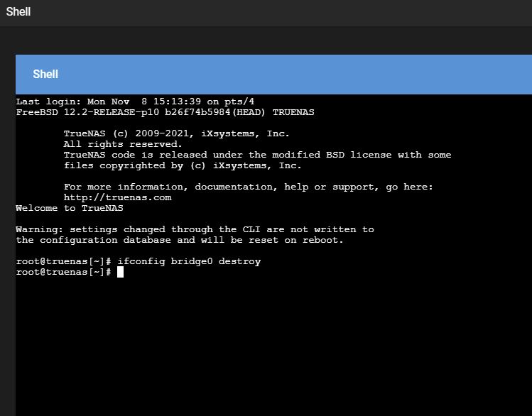

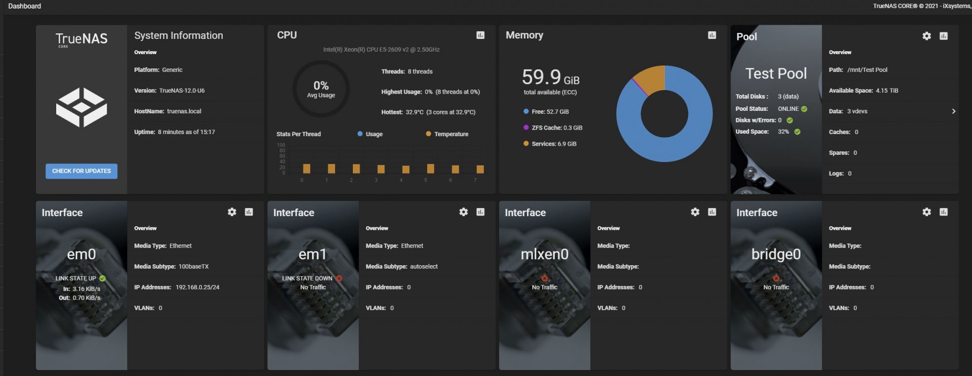

Sabot68
Oct 31, 2021
15
Hi Samuel, Not sure what I'm doing wrong here, i am entering the ifconfig commands as you instruct but the bridge and interfaces do not disappear, they are still visible in the dashboard, I have removed the mellanox card
