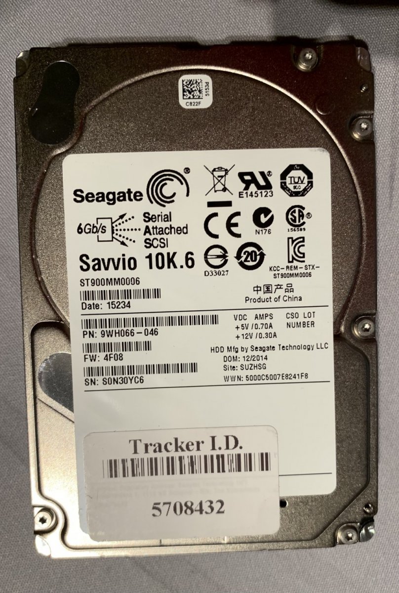

I'll make the wager that the disks are from a piece of enterprise storage hardware, and are using 520-byte sectors.
Any kind of model number or "part number" will help us tell that (or a photo of the top label, with the S/N blocked if you're concerned)

The seller says they are 512. Model nr is ST900MM0006

As @HoneyBadger noted - can you take a picture and post it?

Here you go.

I don't see any vendor part number other than the Seagate, guess I'm off the mark on the 520bps.
But I'm not buying the seller's "explanation" of the drives being damaged by being attached to a bad controller. A bad power supply possibly, but not a controller.
Are you able to read SMART stats from the drives? smartctl -a /dev/daX

According to the datecode the drive is from december 2014 - so good chance it was DOA when you got it :-/
That is what I have tried to tell the seller, but now he says he will give me 10 new disks this time HGST. Just wait and see. If it was not for this COvid business I would have visited him.
