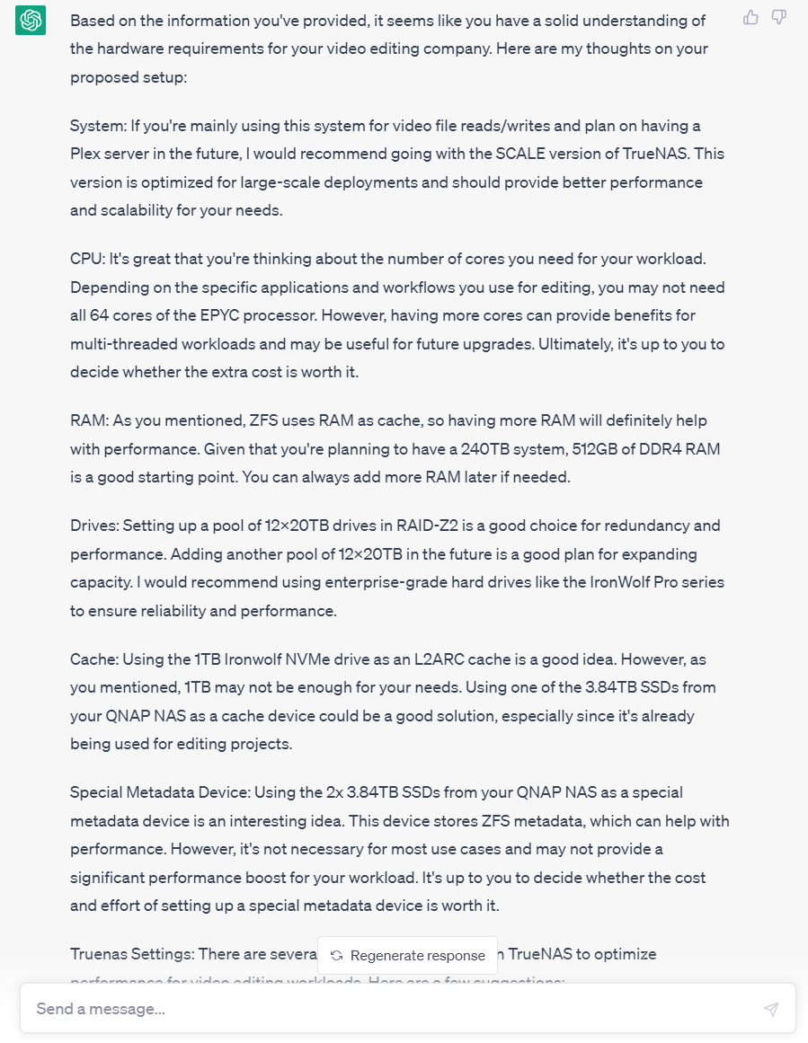

this is literally a Chat-GPT answer, I just checked it. I need real world opinion on this. [image removed, available as attachment for reference]
I've deleted this (also the copies in your response). There is no need for confusing half-truth ChatGPT answers to be posted here. In the future, please feel free to "Report" content you feel may be generated by ChatGPT. Thanks, -JG for the moderation team
thanks! waiting for a real world reply now haha

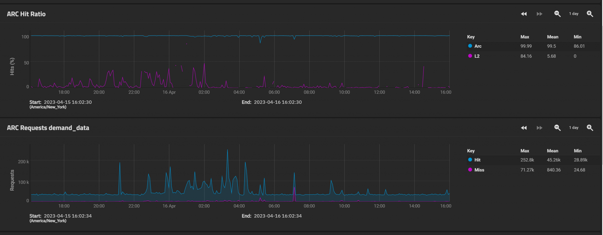

It's all about what you are getting for cache hits. How many of your editors are accessing the same files at the same time? How often are your editors accessing the same files? From my server, which has 256GB of DDR4 and an EPYC 7302, I can see that going from 128GB to 256GB was a meaningful upgrade. However, adding an L2ARC with a 118GB Optane drive didn't yield much additional performance as my mean hit ratio over the past day was 6%. That doesn't mean yours will be the same, and monitoring your system will tell you whether or not you could use more RAM. If your hit ratio is high, then more ram will help. L2ARC Cache should only be considered when you have maxed out your RAM.

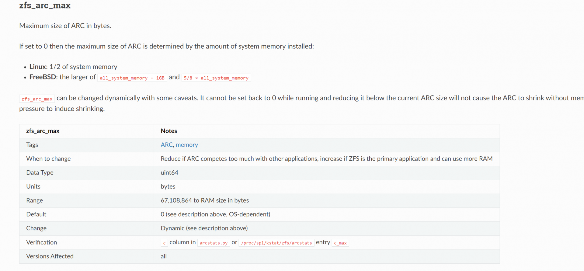

Since SCALE is running Linux, like other have said above, ZFS behaves differently because of differences in the kernel between BSD and Linux. The OpenZFS folks changed the default behavior and will only use 1/2 of your RAM for caching.
Modifying zfs.arc.max will help you tune your performance. But caution is advised, because if you are too aggressive you will create system instability. The limit is there for a reason.

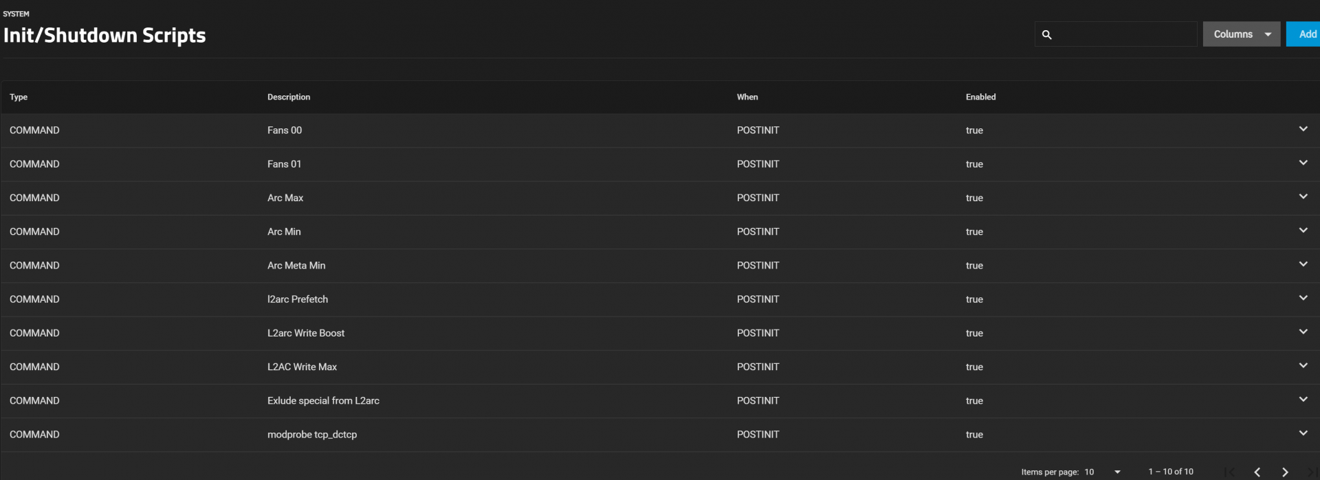

I have a few tweaks that I run on startup in the UI
Most of them are ZFS tunables like the above. I also use Datacenter TCP. @jgreco wrote a neat write up in the resource section talking about high speed networking, here https://www.truenas.com/community/r...ng-to-maximize-your-10g-25g-40g-networks.207/
