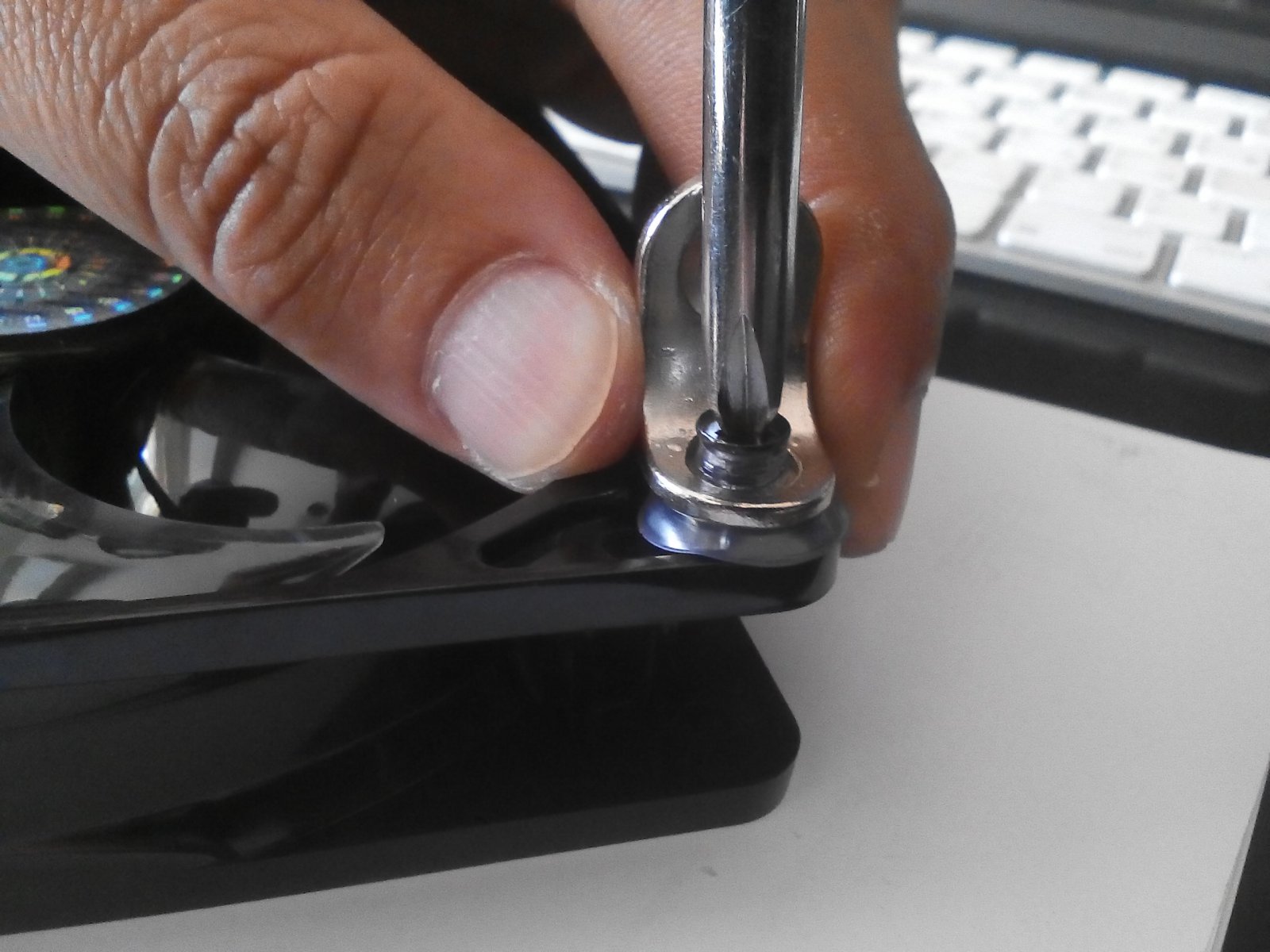

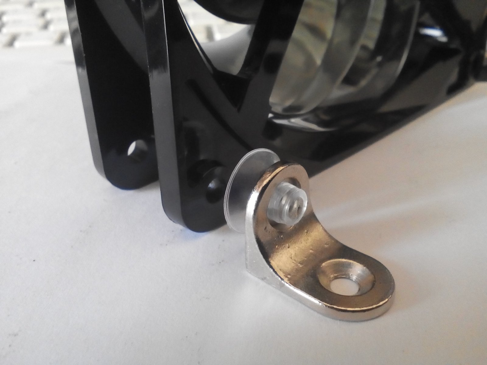

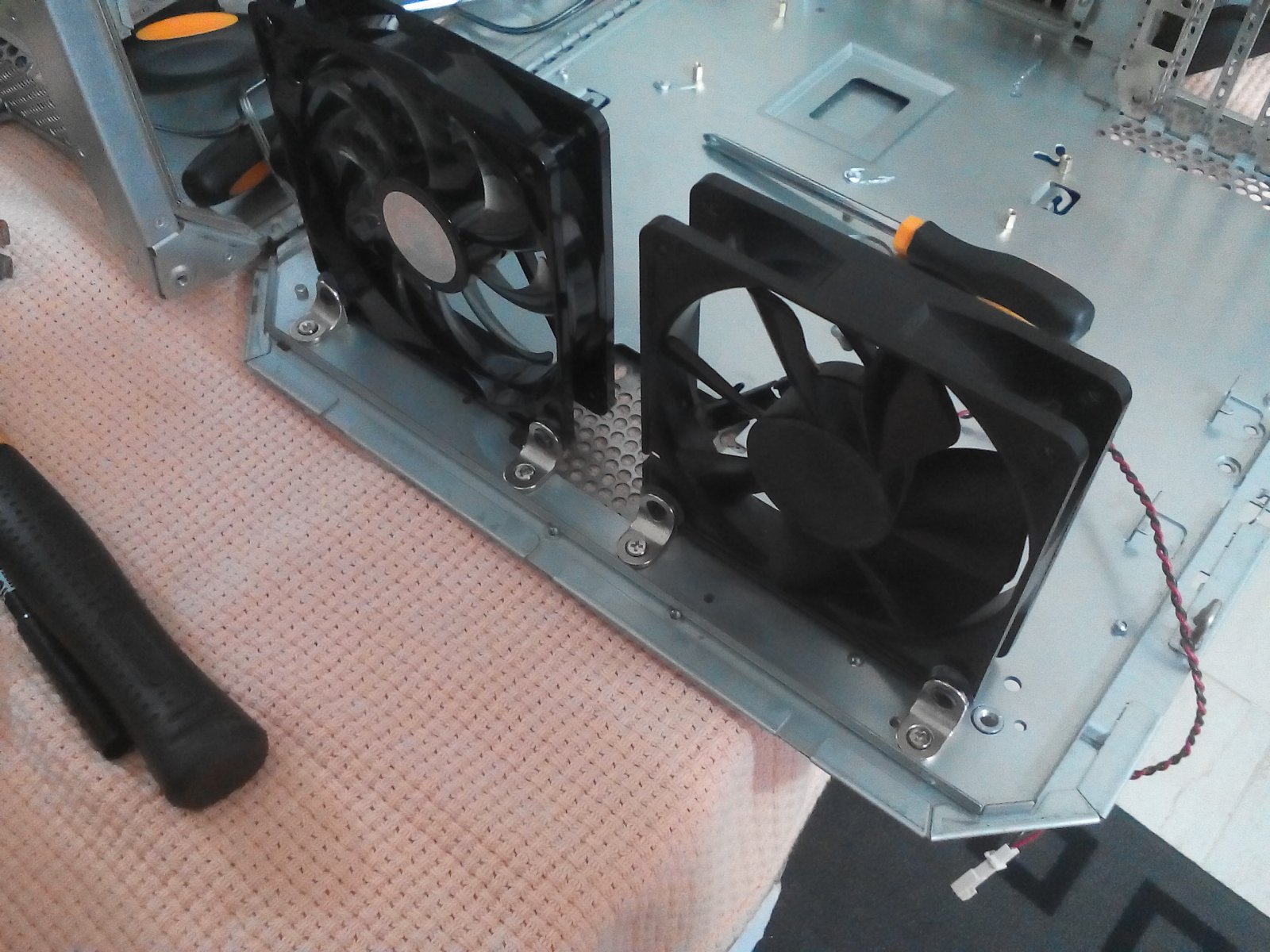

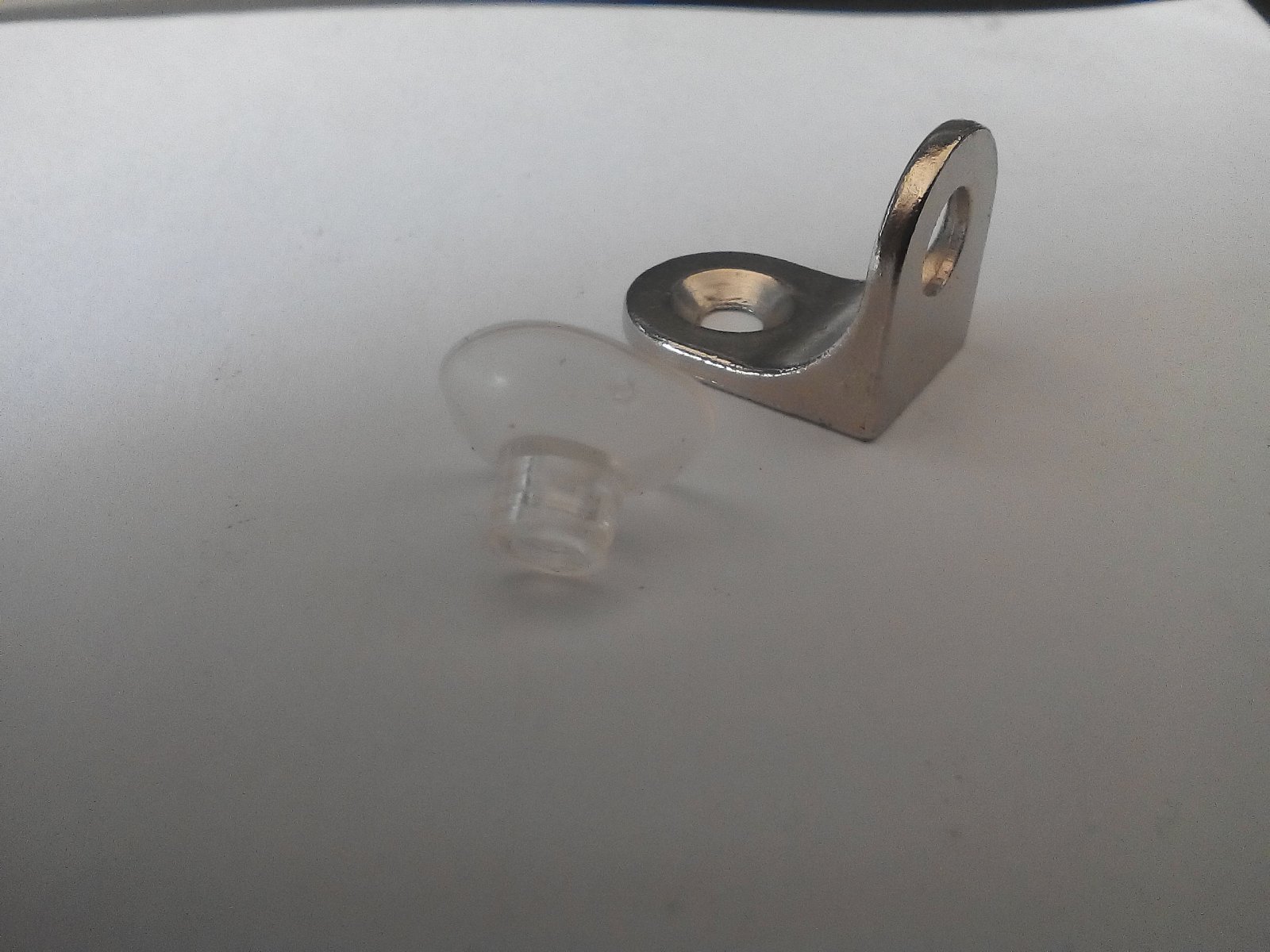

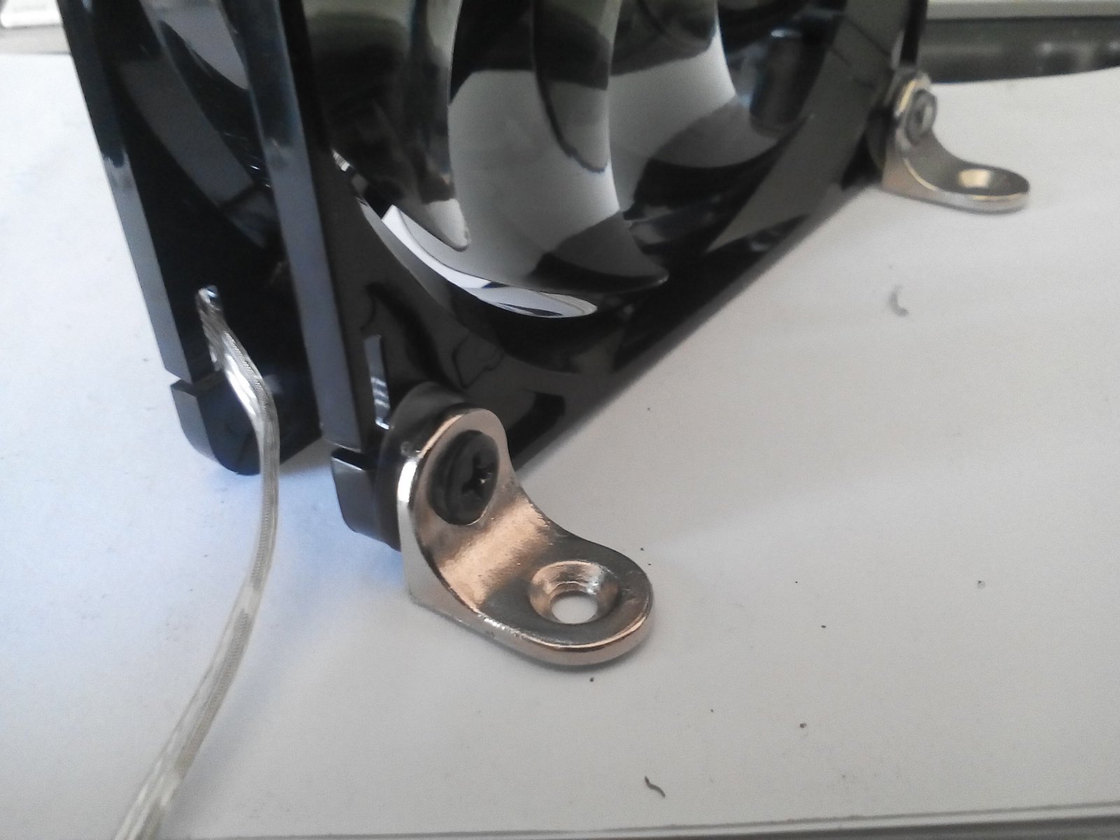

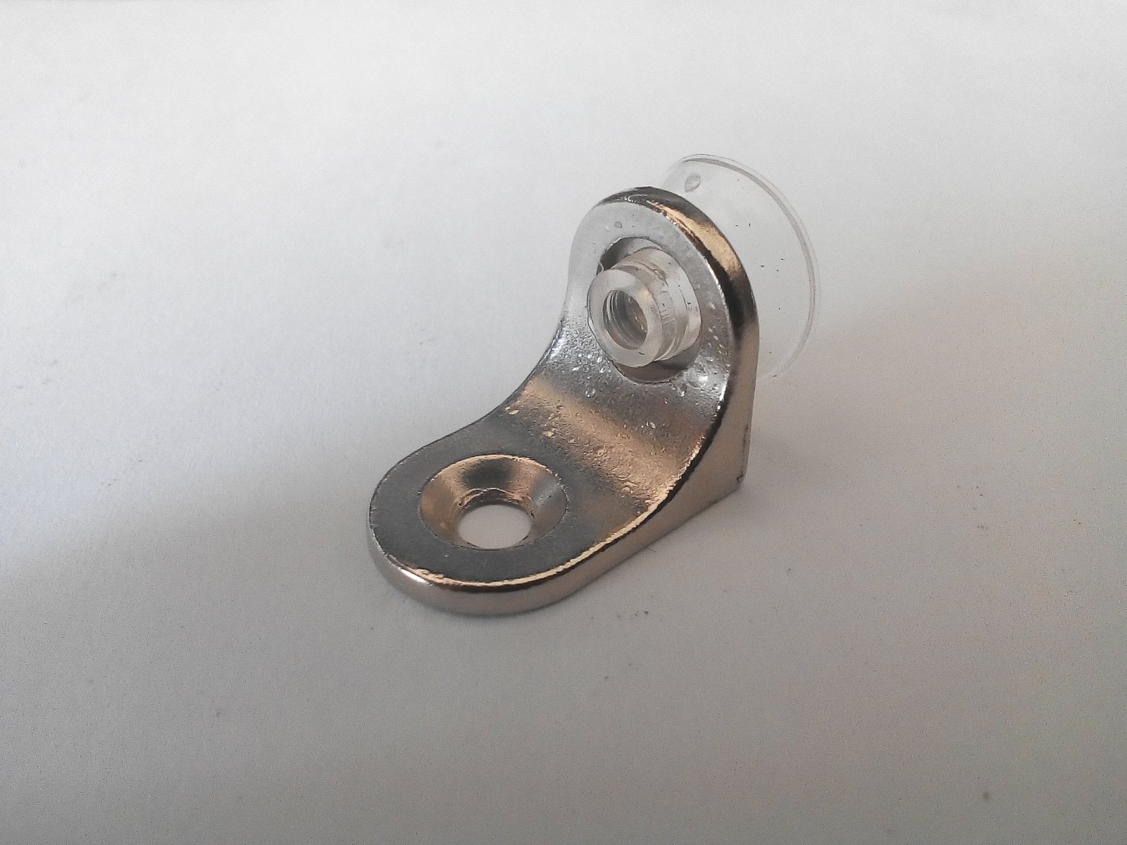

I went to several hardware stores last week trying to find a good method to mound the 3x 120mm fans, what I had in mind that it should be an L shaped bracket with 2 mounting points 1 for the fan screw and the other for the motherboard tray, i was planning to DIY some rubber grommets around the screw holes to reduce noise and vibrations, but i guess i was more than lucky :) than I thought I am.
I found this L shaped bracket usually used to mount small sized glass shelves with tiny suction cups on one side (The shelve side). I needed 6 of these to mount each fan from 2 screws vertically but without hesitation I bought 12 of these as it was very cheap (less than 10 cents/piece) also i wanted to have double the amount of suction cups for my 3 fans to have 2 cups on each screw.

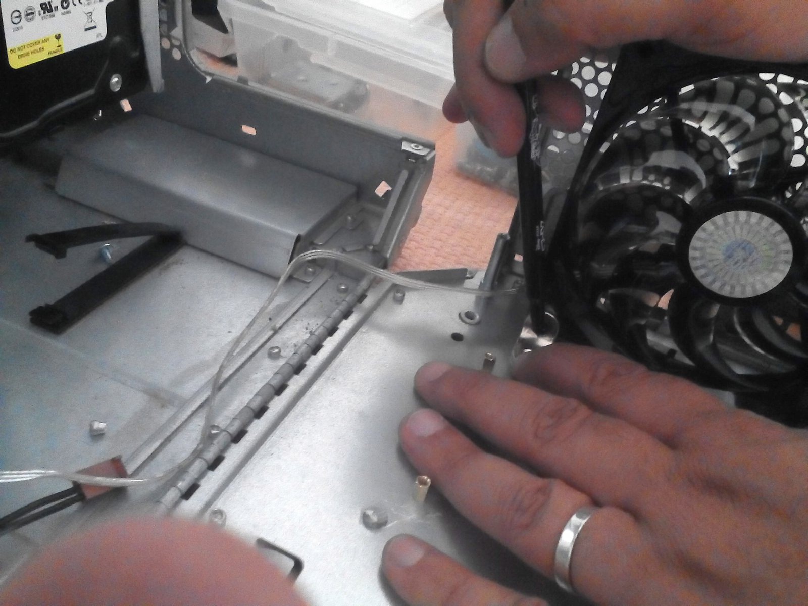

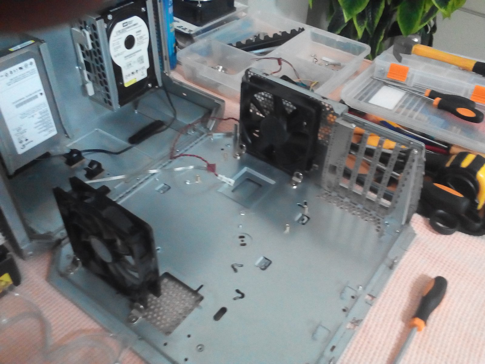

The installation was very easy and suction cups was almost invisible as the are transparent, I had to remove the motherboard first, placed a couple of fans on the left side and marked the drilling spots, brought my trusty Black & Decker drill and drilled 4 holes on the left side and 2 on the right side for the exhaust fan.

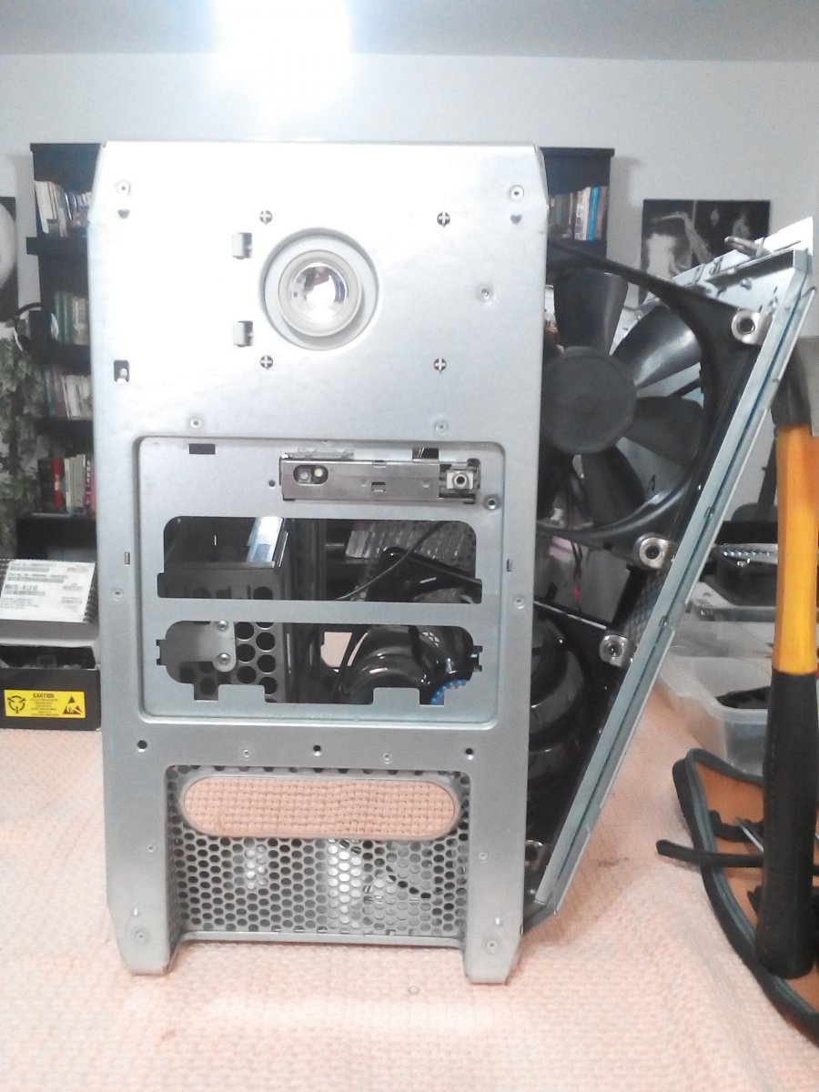

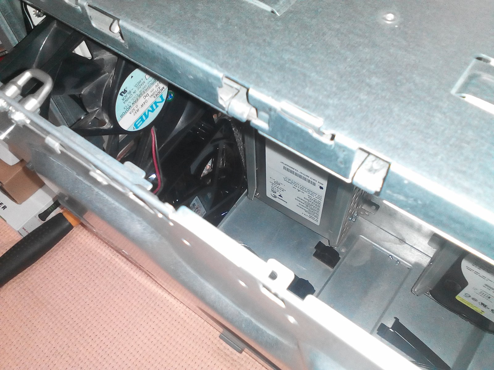

Installed the dual fans on the left side, then I tried to close the motherboard tray, I was so excited to see the fans jumps in place in between the case front and HDD cage, the tray also snapped closed without any troubles.
I uninstalled one of the fans and re-installed it on the right side, to check the placement of the right fan too, and luckily everything went fine except that i have to push the tray harder from the back to close it because the fan is touching the right HDD cage but it shouldn't be a problem. Everything looks awesome.
