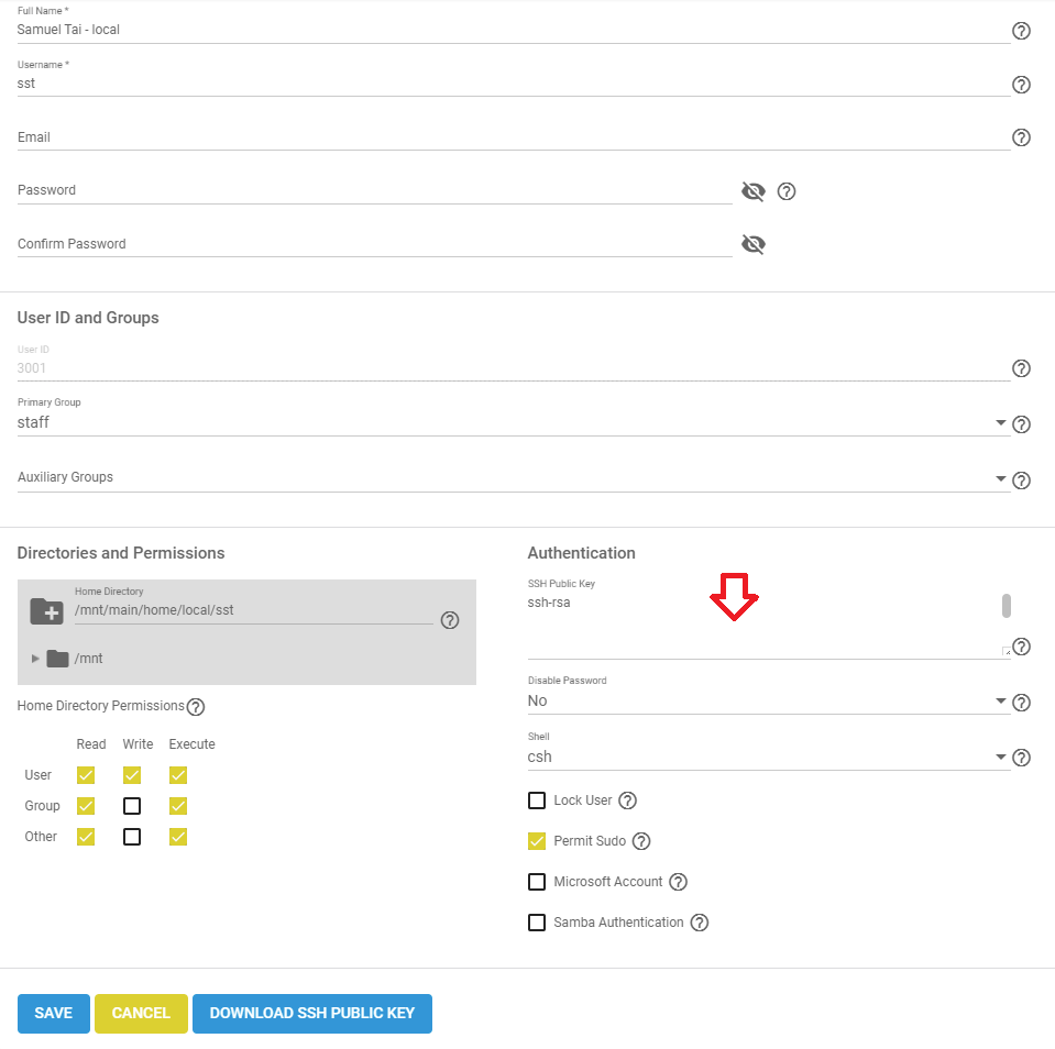

The key here is to generate a SSH public and private key outside of TrueNAS. Here's how I created a SSH user:
In the SSH Public Key field, paste in the SSH public key you just created where the red arrow points. This will populate the user's ~/.ssh/authorized_keys file. Then in PuTTY, set the private key under Connection->SSH->Auth, and the user login under Connection->Data->Auto-login username.
Also remember to set a password for this user, which is the password to use for sudo su - after you've SSHed in.
Samuel Tai
Apr 24, 2020
5,399
Could not change to home directory /nonexistent.
Ah, you didn't create a home directory dataset for your SSH user. The /nonexistent setting means this user is configured without a home directory. This won't work, as a home directory will be needed to store the SSH public key.
