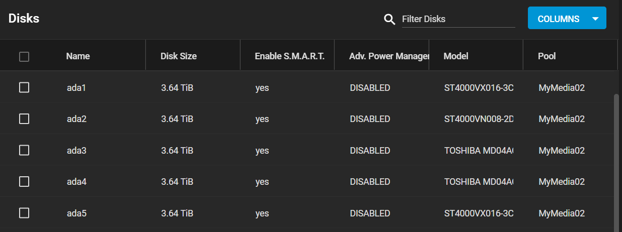

5) Long story short, I resilvered twice more, a total of 3 times and all my data is still there (except for the 3 files). At this point there are 3 new drives and 2 old drives in the pool. But all drives and the pool remain DEGRADED.

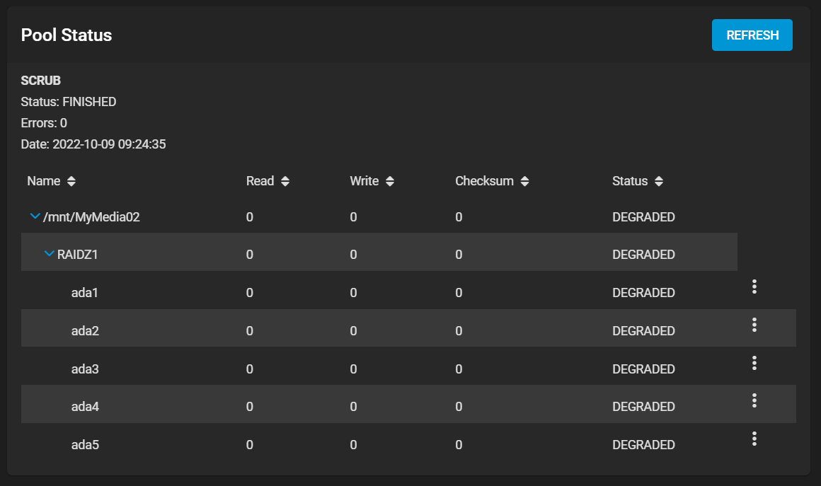

6) So I tried to scrub it, but very early in the process it showed some errors and and as soon as the read errors occured, I got an email about the pool still being degraded. So I deleted the 3 files I knew were damaged and then scrubbed again, now the scrub finished with 0 errors. I also restarted the whole box.
After the scrub finished, however, I got yet another new error message
All drives are OK now, all data is accessible/readable, but the pool is still degraded. How do I fix that without rebuilding the whole pool?

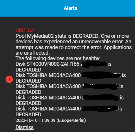

However, those drives don't even exist anymore in that setup. Two more of those Toshiba drives have been replaced for Seagate drives. Something's not right here.New alerts:
* Pool MyMedia02 state is DEGRADED: One or more devices has experienced an unrecoverable error. An attempt was made to correct the error. Applications are unaffected.
The following devices are not healthy:
- Disk ST4000VN000-2AH166 *** is DEGRADED
- Disk TOSHIBA MD04ACA400 *** is DEGRADED
