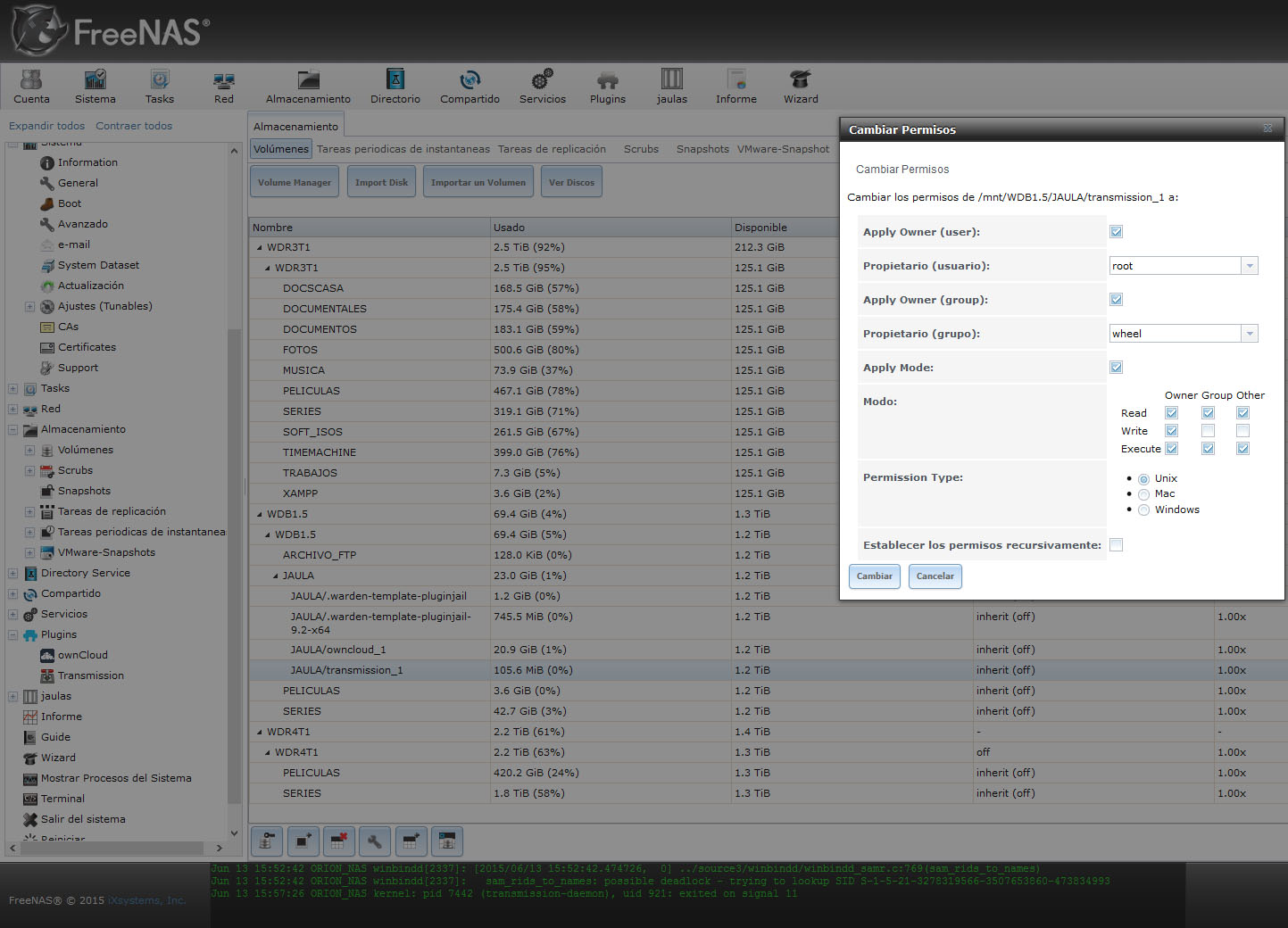

mooneyes
Oct 20, 2012
27
until now, if I can to acces to my "download folder" into my transmission jail, I needed to change my permission in the jail. If I change the permissions then transmission fail, no switch on/off. And if I don't change the permission then I can't acces to download folder.

Joshua Parker Ruehlig
Dec 5, 2011
5,949
Don't ever change ownership / permissions of your jail / plugin datasets. That will, as you've experienced, break your jail. Only ever change permissions of datasets you mount into your jail.
You need to be a little creative to allow CIFS and transmission simultaneous write access to a dataset.
UNIX permissions allow for either..
  1. owner only writing
    • the users UID CIFS and transmission use need to match
  2. group wrinting
    • the users CIFS and transmission use need to be in to be in a group with the same GID, in their userland (jail for transmission)
  3. world writing
    • files need to written with the 666/777 permission level. I added this option for transmission in the transmission menu in the left panel of the freenas webui
mooneyes
Oct 20, 2012
27
In older versions of transmission we could change permissions of the jail and no broken.
I solved my problem now (I think) I've asociated an external storage to my jail, and works perfectly. I made another dataset named "TORRENT" and I've added another storage to my jail, I've changed permissions in the storage and works.
Dec 5, 2011
5,949
That seems strange to me. Anytime you change your entire jail/plugin dataset's ownership/permissions things break. There are jail OS and application files that need specific ownership/permission to work. So even if it seemed to work, I bet a restart of those jails wouldn't work perfectly as the init system would fail.
