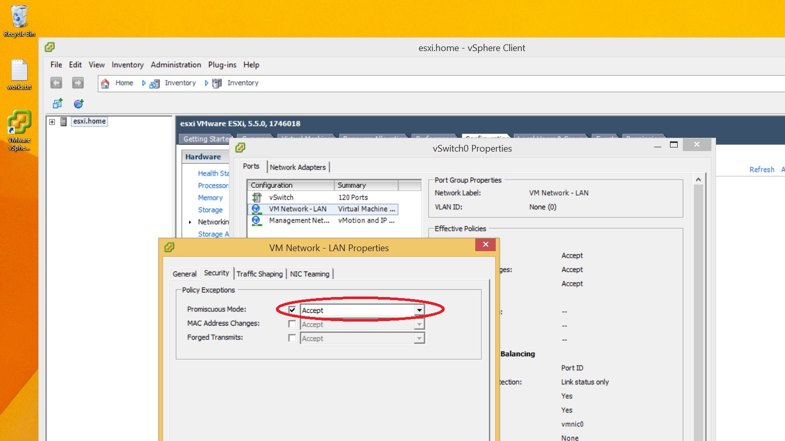

amires
Nov 19, 2012
66
For the VIMAGE to work properly promicious mode should be enabled on the vSwitch freenas is connected to. By default it is disabled.

c32767a
Dec 13, 2012
371
The physical interface underneath FreeBSD's bridge interface needs to be in promiscuous mode for the bridge to properly function:
root@nas3] ~# ifconfig ix1
ix1: flags=8943<UP,BROADCAST,RUNNING,PROMISC,SIMPLEX,MULTICAST> metric 0 mtu 9000
options=400b8<VLAN_MTU,VLAN_HWTAGGING,JUMBO_MTU,VLAN_HWCSUM,VLAN_HWTSO>
ether 00:1b:21:
inet 192.168.1.52 netmask 0xffffff00 broadcast 192.168.1.255
media: Ethernet autoselect (10Gbase-Twinax <full-duplex>)
status: active
[root@nas3] ~# ifconfig bridge0
bridge0: flags=8843<UP,BROADCAST,RUNNING,SIMPLEX,MULTICAST> metric 0 mtu 9000
ether 02:0b:04
nd6 options=1<PERFORMNUD>
id 00:00:00:00:00:00 priority 32768 hellotime 2 fwddelay 15
maxage 20 holdcnt 6 proto rstp maxaddr 2000 timeout 1200
root id 00:00:00:00:00:00 priority 32768 ifcost 0 port 0
member: epair0a flags=143<LEARNING,DISCOVER,AUTOEDGE,AUTOPTP>
ifmaxaddr 0 port 16 priority 128 path cost 2000
member: ix1 flags=143<LEARNING,DISCOVER,AUTOEDGE,AUTOPTP>
ifmaxaddr 0 port 4 priority 128 path cost 20000
[root@nas3] ~#
( This is on physical hardware, no ESX. Note ix1 is flagged PROMSIC)
In VMWare, virtualized physical adapters are subject to ESX security policy, which includes a flag for allowing the adapter to enter promiscuous mode.
http://kb.vmware.com/selfservice/mi...nguage=en_US&cmd=displayKC&externalId=1002934
Changing that setting only affects whether the adaptor is allowed to enter promiscuous mode or not. It does not change operation, unless the OS actually places the card into PROMISC.
Since FreeBSD runs the physical interface in promiscuous mode when using if_Bridge, this setting needs to be enabled in ESX for things to work properly.
