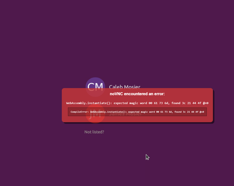

Hey all. I'm running into this issue with bhyve. Getting error code
CompileError: WebAssembly.instantiate(): expected magic word 00 61 73 6d, found 3c 21 44 4f @+0
But the VM otherwise works. The error is blocking the screen and i cant get it to go away and cant find anything about it. It just started showing up a couple days ago and i havnt updated or installed anything new in months.

Try a different VNC client. The error indicates a bug in noVNC where it's passing HTML to the WebAssembly module instead of WASM code.
