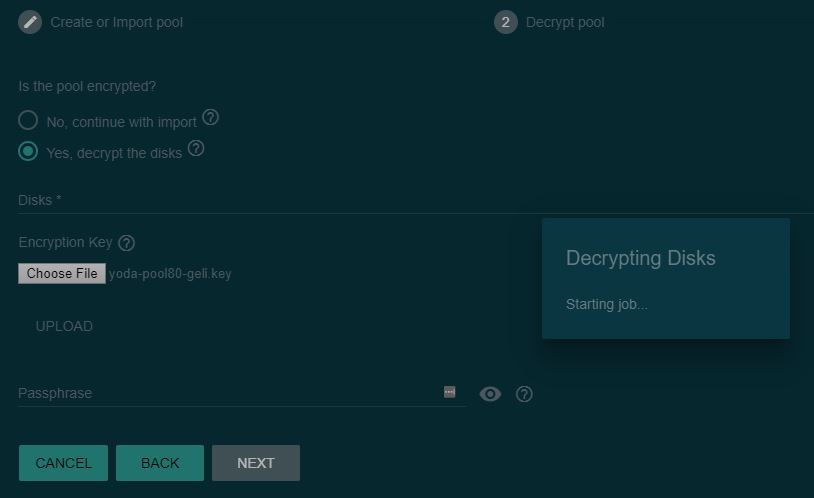

I was writing some data to a cifs share when all of a sudden the copy action was broken off.
FreeNAS showed an alert about an error occurred and data corruption may have happend:
Rebooted the box since and box booted fine except the encrypted drive is now not available.
The pool is shown as locked:
The drive is now shown as unused:

Use the import pool button in the GUI, type in your password. Not sure what you mean by help.
socra
Nov 3, 2018
34
I'm also unsure what you mean by help..don't think I mentioned it in my post ? :)
Anyway I don't have a passphrase just the key file, started the import pool wizard and uploaded the key file and clicked Next. FreeNAS now showing a Starting Job screen. has not moved passed that, don't know how long that normally takes.
socra
Nov 3, 2018
34
Tried it through the legacy UI which goes further but does not present a volume I can select:
Mar 16 15:14:13 yoda uwsgi: [middleware.exceptions:36] [MiddlewareError: Failed to geli detach gptid/bce3642e-fcb4-11e8-abaf-448a5bca6d50: geli: Cannot destroy device gptid/bce3642e-fcb4-11e8-abaf-448a5bca6d50.eli (error=16).
Mar 16 15:14:13 yoda uwsgi: [storage.forms:942] [MiddlewareError: Failed to geli detach gptid/bce3642e-fcb4-11e8-abaf-448a5bca6d50: geli: Cannot destroy device gptid/bce3642e-fcb4-11e8-abaf-448a5bca6d50.eli (error=16).
Mar 16 15:14:13 yoda uwsgi: [middleware.exceptions:36] [MiddlewareError: Failed to geli detach gptid/364b08d6-fde6-11e8-abaf-448a5bca6d50: geli: Cannot destroy device gptid/364b08d6-fde6-11e8-abaf-448a5bca6d50.eli (error=16).
Mar 16 15:14:13 yoda uwsgi: [storage.forms:942] [MiddlewareError: Failed to geli detach gptid/364b08d6-fde6-11e8-abaf-448a5bca6d50: geli: Cannot destroy device gptid/364b08d6-fde6-11e8-abaf-448a5bca6d50.eli (error=16).
Mar 16 15:14:13 yoda uwsgi: [middleware.exceptions:36] [MiddlewareError: Failed to geli detach gptid/c595e422-ff7f-11e8-8cfa-448a5bca6d50: geli: Cannot destroy device gptid/c595e422-ff7f-11e8-8cfa-448a5bca6d50.eli (error=16).
Mar 16 15:14:13 yoda uwsgi: [storage.forms:942] [MiddlewareError: Failed to geli detach gptid/c595e422-ff7f-11e8-8cfa-448a5bca6d50: geli: Cannot destroy device gptid/c595e422-ff7f-11e8-8cfa-448a5bca6d50.eli (error=16).
Mar 16 15:14:39 yoda GEOM_ELI: Device gptid/9de944b6-1676-11e9-b2dd-448a5bca6d50.eli created.
socra
Nov 3, 2018
34
Latest update I can give to this, is that I started over and luckily had somewhat of a backup. Will move off of encrypted drives as soon as I can ($$$), don't trust the current implementation of encryption.
