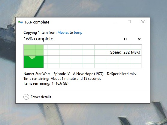

Well the results are in, I got the Unifi 6 24 Switch which includes 12 2.5Gbps ports. I have everything hooked up now, the x550 Intel startech.com card in my Freenas (Little) backup server, I wanted to test it out there first, have a second Intel nic coming for my main Freenas server tomorrow. I have my PC using a USB-C Realtek 2.5Gbps ethernet adapter in Windows. Everything is working great, the switch recognizes both adapters as 2.5Gbps. Everything was left as Auto-negotiation as well. I think the Freenas box needed a reboot after plugging into the 2.5Gbps switch port as I couldn't manually get it to update its speed, that was really the only hiccup in the process. The picture speaks for itself, 282MB/s! Anyone looking for a solid 2.5Gbps setup, this worked great and out of the box, no special drivers needed!

jayecin
Oct 12, 2020
79
Really tempting me to pull the trigger on my 10gbps interface build...
