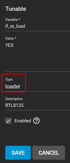

Hi @iocenter,
Thanks to introduce "tunable", it is easier. I guess the "Type" should be "loader", right?
TK

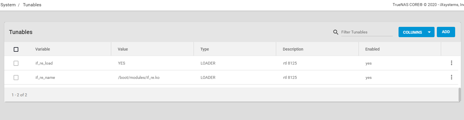

jubjubs
Oct 12, 2021
i did this and my NIC still doesn't work. see screenshot. am i missing a step here? added tuneables and rebooted and nothin.
jubjubs
Oct 12, 2021
Nope im good now. Was on truenas 12.0-U1.1 but updating to 12.0-U6 made it work.
