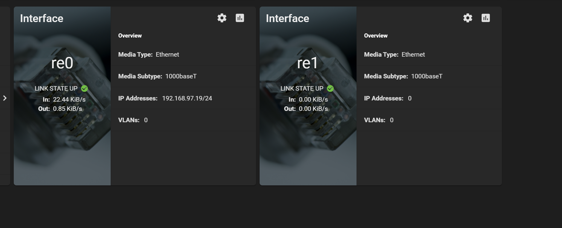

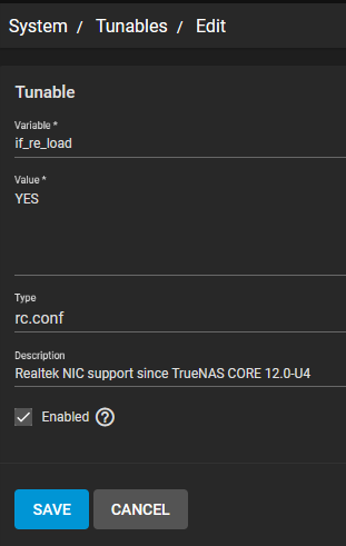

For everyone else who hasn't heard of Tunables before you can add them in Menu - System - Tunables
Here's a screenshot of the first variable:
Thank you for the first variable..however how is the second one supposed to be configured?
9,700
9,700
I can see both NIC's however both are showing as 1000baseT weird
What cables are you using and what switch are you connected to?

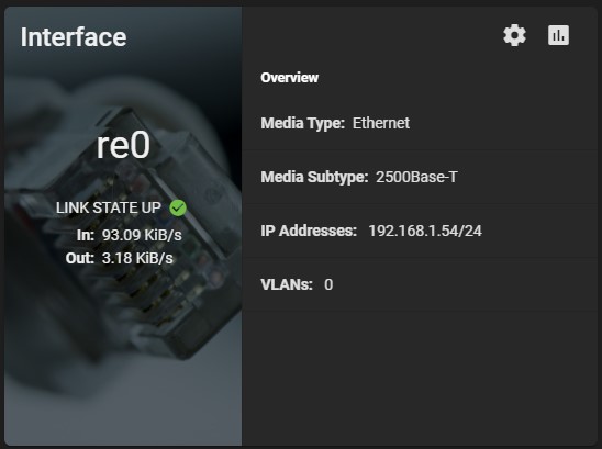

Randy...
Dec 30, 2020
9
Very cool - This worked for me as well.
As @acidwap indicated - the tuneable "type" needs to be "loader" for both. Worked like a charm - the pics are always appreciated over here.
I'm using a pair of cheaper RTL8125 2.5GbE PCIe 3.0 cards (one in the TrueNAS, one in my Desktop) and a cheap TP-Link 2.5GbE switch. It's saturating over 250-260MB/s with most files - and still bests the 1GB connection for the smaller/random transfers. I was even able to saturate the 2.5GbE connection to my desktop while also saturating the on-board Gig-E NIC to another system!
I'm liking TrueNAS more and more - and the support here is fantastic. Thanks all.
