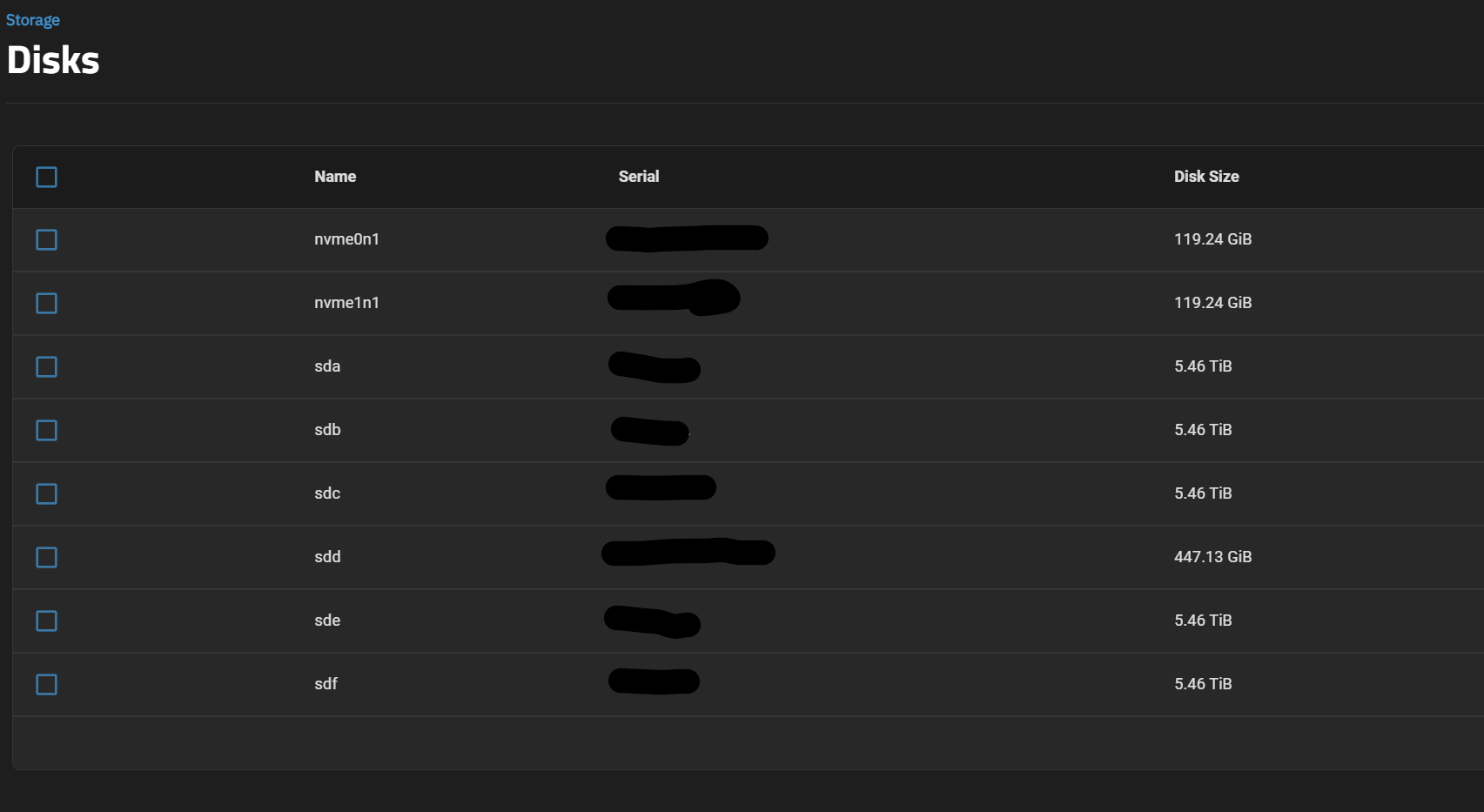

Im a complete beginner with trueNAS and linux, but after running my server for 3 months I got an error in TrueNAS:
device: /dev/sdg [SAT], ATA error count increased from 0 to 1.
However, when i look at all the disks in my system, i can't find a /dev/sdg drive
sda, b, c, e, f are my 5 ultrastar 6TB disks
sdd is a 500GB SSD that runs my apps (kingston, 2 weeks old)
NVME1n1 is the boot NVME (sketchy chinese quality, but i keep a backup of the config files)
NVME0n1 is a L2ARC for the spinning rust (good quality, 2 weeks old).
when i run smartctl -a /dev/sdg i get:
Smartctl open device: /dev/sdg failed: No such device
Am i just too stupid to understand this right? am i looking in the wrong place? or is the error that i received just bogus and should i ignore it?

All disks are accounted for. The server also only has 6 sata connections, so that comes down to my 5 disks and the app-pool SSD.

to me this all looks good... and no sign of /dev/sdg

SMART Error Log Version: 1
ATA Error Count: 2
        CR = Command Register [HEX]
        FR = Features Register [HEX]
        SC = Sector Count Register [HEX]
        SN = Sector Number Register [HEX]
        CL = Cylinder Low Register [HEX]
        CH = Cylinder High Register [HEX]
        DH = Device/Head Register [HEX]
        DC = Device Command Register [HEX]
        ER = Error register [HEX]
        ST = Status register [HEX]
Powered_Up_Time is measured from power on, and printed as
DDd+hh:mm:SS.sss where DD=days, hh=hours, mm=minutes,
SS=sec, and sss=millisec. It "wraps" after 49.710 days.
Error 2 occurred at disk power-on lifetime: 2407 hours (100 days + 7 hours)
  When the command that caused the error occurred, the device was active or idle.
  After command completion occurred, registers were:
  ER ST SC SN CL CH DH
  84 43 00 00 00 00 00  Error: ICRC, ABRT at LBA = 0x00000000 = 0
  Commands leading to the command that caused the error were:
  CR FR SC SN CL CH DH DC   Powered_Up_Time  Command/Feature_Name
  60 00 a8 08 bd 94 40 08  23d+21:51:05.439  READ FPDMA QUEUED
  60 00 48 08 c5 94 40 08  23d+21:51:05.356  READ FPDMA QUEUED
  60 00 a0 08 b5 94 40 08  23d+21:51:05.356  READ FPDMA QUEUED
  60 00 40 08 ad 94 40 08  23d+21:51:05.335  READ FPDMA QUEUED
  60 00 98 08 a5 94 40 08  23d+21:51:05.335  READ FPDMA QUEUED
Error 1 occurred at disk power-on lifetime: 2392 hours (99 days + 16 hours)
  60 40 20 00 42 3d 40 08  23d+06:48:49.801  READ FPDMA QUEUED
  60 40 18 c0 41 3d 40 08  23d+06:48:49.763  READ FPDMA QUEUED
  60 40 58 c0 3f 3d 40 08  23d+06:48:49.760  READ FPDMA QUEUED
  60 40 10 80 3f 3d 40 08  23d+06:48:48.825  READ FPDMA QUEUED
  60 40 08 40 3f 3d 40 08  23d+06:48:48.824  READ FPDMA QUEUED
# 1  Extended offline    Completed without error       00%      2406         -
# 2  Extended offline    Completed without error       00%      2121         -
# 3  Extended offline    Completed without error       00%      1378         -
# 4  Extended offline    Completed without error       00%      1124         -
# 5  Extended offline    Completed without error       00%       646         -
# 6  Extended offline    Completed without error       00%        30         -
# 7  Short offline       Completed without error       00%         7         -
# 8  Extended offline    Aborted by host               90%         5         -
joeschmuck
Old Man
May 28, 2011
10,995
So you could be looking at a SATA cable or connection issue with this drive. Keep an eye on the UDMA_CRC_Errors. If they increment then you need to examine it. Normally these are not the controller nor the hard drive. If you examine all the SMART data from all your drives, if you are seeing this value not at zero, then it could be the motherboard chipset, or a bad batch of SATA cables, or if you have the drives mounted in a removable tray system, that could be suspect as well.
As for the sdg issue... I suspect this was actually sdf. When the system powers up it assigns drives as it sees fit (normally by which one is ready first), but it is odd to skip a letter. That is the only thing that makes some sort of sense. Keep an eye on things for a while.
Very few SMART tests have been run, that's not great, but the disk isn't reporting anything beyond some errors on the interface (possibly did to a bad or loose cable).
Tha_Reaper
Dec 2, 2023
10
Thanks. the error happened not during a boot, but after the system has been up for 20 days. So the timing is a bit weird.
You make a good point with the connection issue. The SATA cables are cheap ones from aliexpress. And i use a Jonsbo N2 case, so also removeable drive trays.
I'll keep an eye out, and stop worrying for the time being. thanks for both of your time. I'll report back if anything changes
