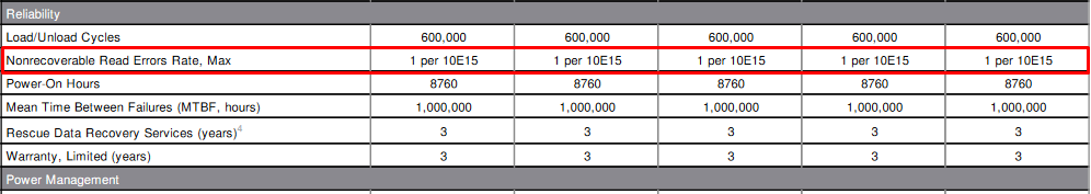

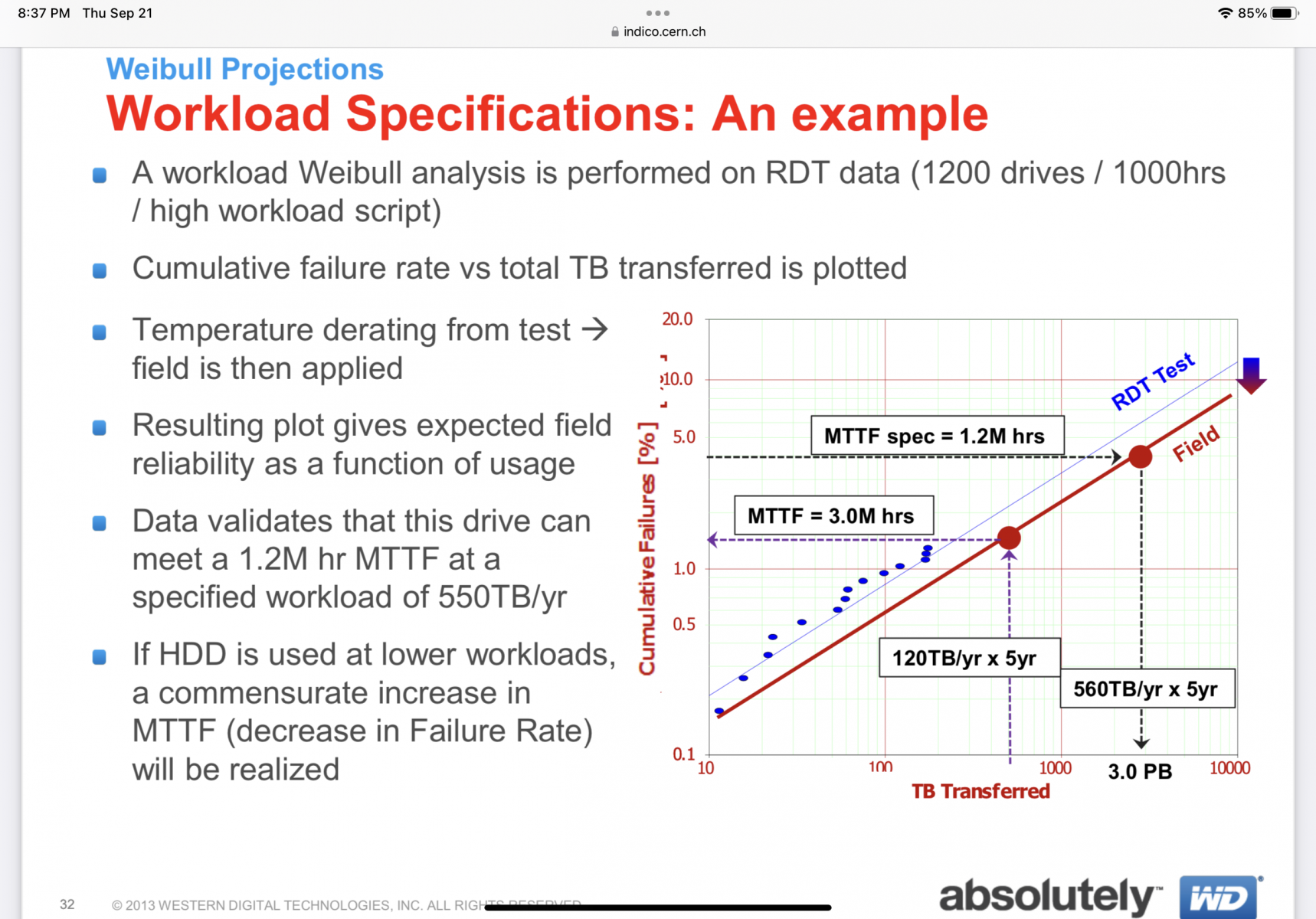

Something seems odd to me. Let’s take a simpler example to explain my position. Take a pool with one vdev consisting of a 2-disk mirror. Let the disks be Segate Exos 20 TB drives. They have a stated MTBF of 2.5 million hrs, at an annual use rate of 550 TB and have a 5 year warranty.
So first off - what is the probability of at least one UE over their 5 year life? That would be 2 drives x 5 yr x 8760 hr/yr / 2,500,000hr/drive = 0.035. In other words, there is only a 1 in 28.5 chance of getting even one UE over their 5 year warrantied life.
So now lets say we have a UE on a drive, the most likely result is, the other drive in the mirror has a good copy of the bad data, and the drive is repaired, requiring just a few writes on the drive that had the UE. But let’s take the case where the drive is failed, or where we take a no-tolerance position, and we replace the now suspected failing drive. This will require a total read of our good drive, without any UEs.
What is that probability? Instead of using a 1 in 10^14 bit error rate, I go back to the stated 2,500,000 MTBF, and a 550 TB yearly rate. Reading 20 TB is 20/550*8760 hours = 318.5 hrs.
318.5 hrs /2,500,000 hrs/failure = 0.00013 or about 1/7800. In other words, even if we have an error that requires disk replacement with subsequent copy of the entire 20 TB drive there is only a 1/7800 that the copy will fail, resulting in a lost pool.
This seems good enough to me.
Tell me where my analysis is flawed.

The flaw is equating Unrecoverable Read Error with failure. "Failure" is the disk breaking down, mechanically or electrically. An URE is not a "failure" and you can't get the URE rate from the MTBF.
Resilver does not require a total read of the good drive, only of the actual data on it.
Let 'u' be the URE rate.
The probability of not getting an URE on one bit is p(1) = 1 - u.
For 'n' bits read, p(n) = (1-u)^n. Logarithms will help with computing: ln(p(n)) = n*ln(1-u) ≈ -u * n.
So: p(n) ≈ exp(-u*n)
For N bytes: p(N) ≈ exp(-8*u*N).
Say we have 12 TB of data on the drive (60% full) and u=1E-14:
p(12TB) = exp(-8*12*1E12*1E-14) = exp(-0.96) = 0.38
i.e. a 38% chance of a smooth resilver, without having to fetch the backup to restore an individual file where an URE occurred. Do you take your luck with it, or go for 3-way mirrors (or raidz2)?

But where does 10^-14 error rate come from? I don’t see it on the manufacturers data sheet. The UE must come from data that was previously written, and now can no longer be read. But aren’t these caught when the disks are periodically scrubbed? And corrected by reading the corresponding block on the mirrored disk.
Are you suggesting a nearly full 20 TB disk that was just successfully scrubbed, and now is constantly being read, will come up with a UE every 10^14 bits? That is more than 1 UE expected for each complete read of a 20 TB disk.

But I’m questioning the facts here. I don’t question the formulas. But I question the 10^-14 bit read error rate. I believe if you wrote a series of 100gb files and filled up a 20 TB disk, you could reliably read the entire disk contents back several times without an error. Many home theaters owners do just that.
They are in the data sheets, often called different ways.
Edit: quoting the resource linked in this thread.
I haven't been able to find reliable information about known how the OEMs test UREs and what are the legal constrains behind this process: we don't know values such as the variance or standard deviation between the reported value and the actual values, but we are observing a huge discrepancies; having a scientific background this annoys me greatly. [...] what's certain is that the lack of independent and reliable testing (scientific method and large enough population) in conjunction to perhaps a grey area in regulations is hurting us consumers.

I think I understand this better now, and agree with what you guys have been saying. Thanks for everyone who contributed.
I found this presentation from cern which goes a long way into understanding modern drive error mechanisms. https://indico.cern.ch/event/247864...ts/426734/592321/HEPIX_October_2013_ver_6.pdf
Attached is a slide that shows cumulative errors vs TB read. From this graph, it sure looks like one can expect read errors when reading an additional 10 TB, especially as the drive gets older.
Err… actually from your own post #10.
20 TB Exos drives have a specified rate of 1E-15 (datasheet), which then works out to p(12TB) = 0.908. So a 2-way mirror vdev of 20 TB Exos drives which loses one drive while 60% full would have a 91% chance of resilvering without issue. Better… but there's still a less-than-fully-comfortable 9% chance of having to go for the backup to restore a damaged file.
20 TB Ironwolf and WD Red Pro drives are also rated at u=1E-15. WD Red Plus are rated at u=1E-14, but this line tops at 14 TB "only". (Still, no-one is going to like the calculation for resilvering out of a 14 TB Red Plus drive with 8-10 TB of actual, valuable, data on it.)
Take home points: Do not entrust large amounts of valuable data to vdevs/pools with only one degree of reduandancy. And ALWAYS HAVE BACKUPS!
