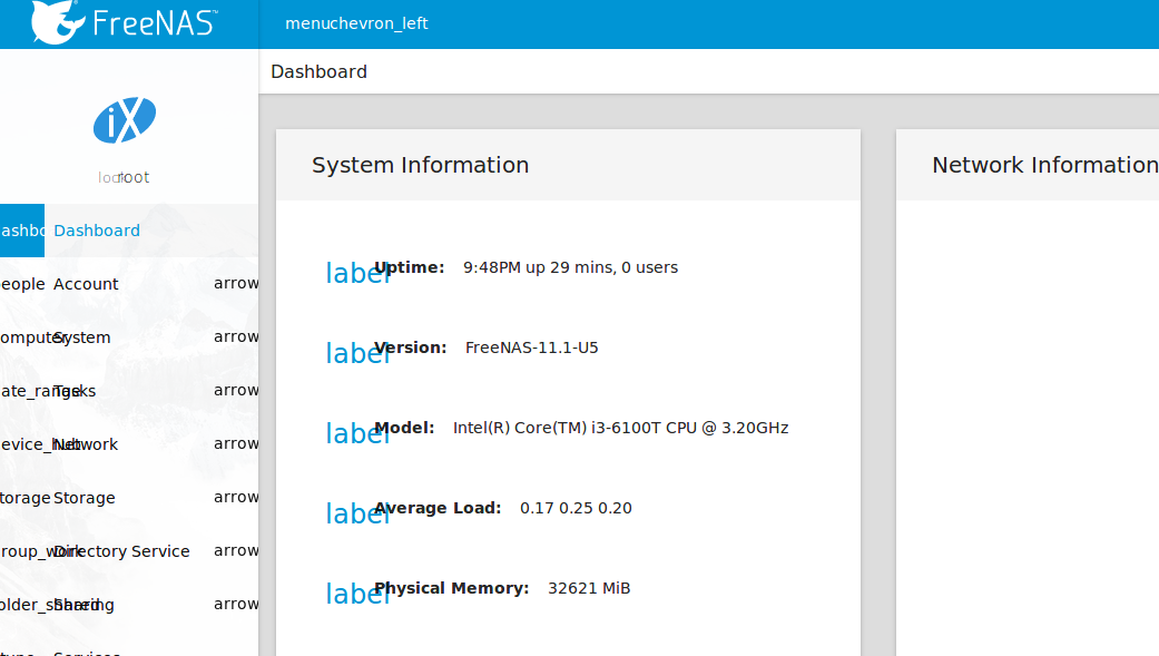

Did you find how to get into the new UI? There is no link to try the beta UI that I can find...
May 2, 2017
211
Just type in "/ui" after your URL and it comes up. But I get the missing graphics and scrambled interface at the moment.
