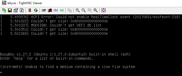

I'm not reading a thing about an bhyve update. Does anybody know if its possible to run Ubuntu 18.04 via the VM option in this new Freenas release?
Wouter
Jun 27, 2016
36
And to answer my own question:
I tried the 18.04 installer on U5 today, no luck :(
