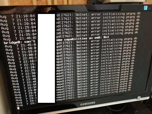

I did a successful update from FreeNAS-11.1-U5 to FreeNAS-11.2 beta2. Also bhyve VM's were working. Then, at night, suddenly my system freezes. I had to power down and start the machine again. I looked at (remote stored/saved) syslog messages, nothing strange.
then, a day later, again. System freezes, nothing real strange on the monitor or syslog. Now I'm back at FreeNAS-11.1-U5 and no troubles at all.
Anyone that can give me hint to do trouble shooting? Yes, I know, this is beta. Just asking for info to help the project, see what's going on and maybe file a bug report.

Could it be a memory starvation issue? Do you have autotune enabled or any other tunables? What are your specs and how are your VMs configured?

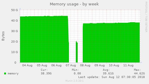

About the memory starvation issue: the VM's are small, don't do a lot. I added munin picture below. The box is still running fine, now with 11.1u5. What I can do, is disable the autostart of the VM's, then boot into 11.2beta2 again and see what happens. If it freezes again, it shouldnt have anything to do with the VM's (right?). No tunables set (never did this). Autotune is disabled.

At this point we need you system parts list. In the graph I see 44GB of memory usage but I have no clue if you have 128GB or 48GB of ram. Also what are the specs for the VMs. We like technical details!

Well you have 32GB of RAM and according to that graph your using 44GB. You're swapping 12GB... you may want to try setting your zfs.arc.max to something around 12GB. Also if you can afford it, remove one of your vCPUs. You CPU seems a bit over subscribed and I don't mean CPU use percent but ready time could be exceedingly high. I doubt the CPU oversubscription would cause a crash but everything may be a bit more responsive with fewer vCPUs. Keep in mind your effectively trying to schedule 2 dual core systems and a quad core with only 4 cores and that quad core is doing a lot of things for ZFS...
