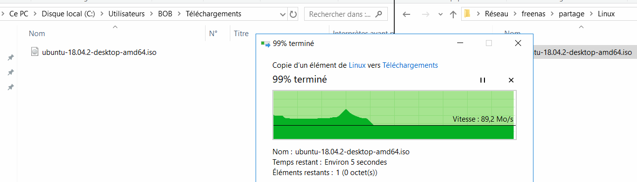

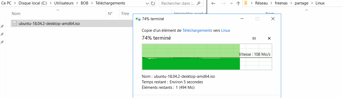

Just to illustrate the issue.
Working great :
Not working great (it freezes at the start then suddenly reaches the end) :
