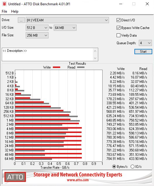

Hi All,
I am using iSCSI and Fiber channel QLogic 2564 HBA's. My FC switches are old 4gbps Brocade 4900's and I am wondering if there is any tweaking to do on the iSCSI side for more threads or more buffers?
Hi All,
I am using iSCSI and Fiber channel QLogic 2564 HBA's. My FC switches are old 4gbps Brocade 4900's and I am wondering if there is any tweaking to do on the iSCSI side. My zpool is a 3 way mirror of 3tb 7200rpm SAS drives with presently 21 drives in the pool for 7 stripes soon to be 14 stripes.
I am using VMware 7.0.2 Build 17867351 and TrueNAS Core 12.0-U4 with Dual E5-2660 v2 processors with 192GB of RAM. The VM is a windows server 2019 with 8 cores and 8gb ram.

I have a lot of RAM and CPU on these boxes. I will do tests with NVME so that I know it is not the fiber channel but the disks that are the issue. I did get a fast svmotion from one LUN to another LUN on TrueNAS Core 12.0-u4 the other day at 750mb/s but was not able to repeat that and had a reboot as well as changes after that.
I think there is a missing link on the fiber channel cards when loading the driver/firmware. I assume when the driver loads it pushes the firmware TrueNAS wants to use.

The LUNs were between two TrueNAS hosts, so it should have been fast.
I am using vmdk on vmfs and that is on a zvol, not a file
I have looked at the brocade switch with porterrshow and have no errors for many days and even under heavy io.
I did find one of 48 drives had smart errors increasing and another one during the smart test at noon was still running after 2.5 hours later, so I assume that one is junk. The other bad thing is I added vdevs rather than doing all 48 drives at once, this cause unbalanced io across all the vdevs, some were way too full at over 90%. Since I have 2 idenical TrueNAS hosts I get to test again once I get all my drives healthy again.
