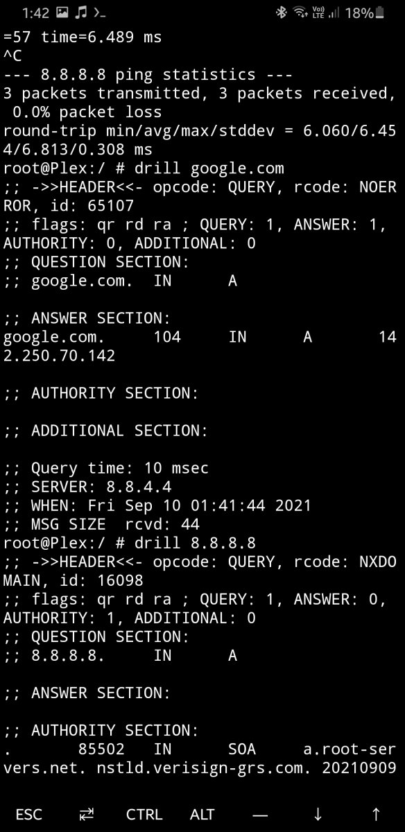

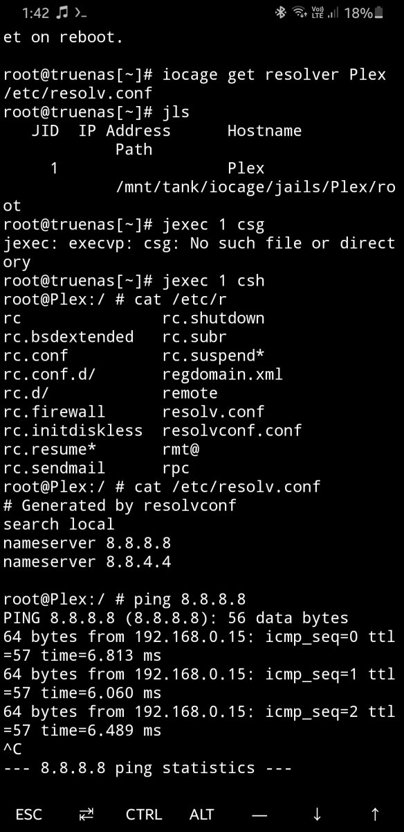

Just wondering if this is still a known issue. I recently updated to TrueNAS-12.0-U5.1 and my previously working Plex jail and Ubuntu Server VM seem to no longer be able to access DNS servers, despite having access to the internet (ping 8.8.8.8 works but google.com does not). The truenas itself has no issues, it appears only to have issues within jails and VMs. Been pulling my hair out looking for a solution all week as Plex has become unusable outside my local network.

What's the output of iocage get resolver <jailname>?
What's in /etc/resolv.conf inside the jail?
Can you ping/ping6 that address from inside the jail?
Can you manually use drill inside the jail to query that server?

Apologies for the screenshots from my phone, but these are the outputs to the commands you asked for. The resolve.conf inside the jail mimics that of the TrueNAS (both are the same). I can ping this nameserver from inside the jail and I can use drill to manually query that server. I just can't ping any host names

So drill google.com works while ping google.com doesn't? Sorry, that's weird. No idea. Next I would do a packet trace on the NAS host with tcpdump.
Is this a VNET jail? Does it use NAT? If yes to both, I would suspect the latter.
