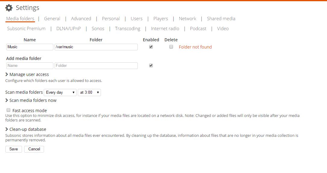

Hi - I am having an issue with the new subsonic (I didnt have the old one installed since my last freenas reinstall).
I setup the plugin, am able to access the web admin.
I have storage:
/mnt/Pool/Shared/Transfer (pool within freenas)
Storage is pointing to:
/var/music on subsonic.
It is unable to find the directory when I add it with /var/music. When I browse the storage in the jail, so I can add a new directory, the /var/music is redirecting to /mnt/Pool/Shared/Transfer - so the jail is seeing the storage but is unable to add the folder within the web admin.
I get a Folder Not Found error each time. I rebooted the jail, rebooted freenas, nothing seems to work.
The directory in the pool has a group of wheel, the subsonic plugin is in the wheel group.
Any suggestions for getting this going?
Thanks,
Rich

It looks like the jail can see the directory but subsonic just cant see the folder when I try to add it. It keeps saying "Folder Not Found". So it is unable to scan the directory for the music files.
The default root user is placed in the group called "Wheel". The jail subsonic is in the wheel group so I made sure that the permissions for the folder with the music are in the wheel group also.
Again it keeps saying folder not found. Any other ideas?
Thanks,
Rich

can you show the output of 'ls -l /var/music'
also you may want to try initiating a rescan in subsonic.
when you say the plugin is in the wheel group, I doubt you know exactly what you are saying.
https://forums.freenas.org/index.ph...plugins-write-permissions-to-your-data.27273/

When I goto users I dont see the media user in my user list. Can I just add that user (if I can find it) to the 'wheel' group which has permissions?
Or am I better off making a new dataset for music & leave all default permissions, creating a cif share & then copying the music to that directory?
Thank you for your help!
Joshua Parker Ruehlig
Dec 5, 2011
5,949
read the opening post of the thread I linked. I explain there that users in the jail and freenas are not shared.
also I explain how you could use group ownership to access files (Solution 3).
