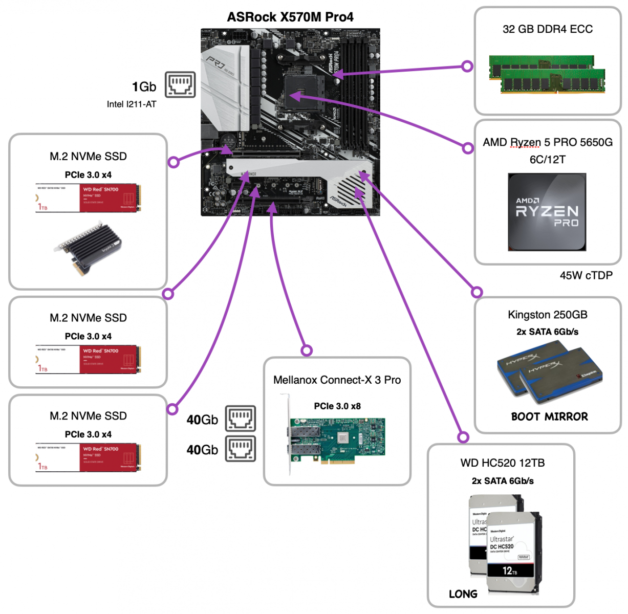

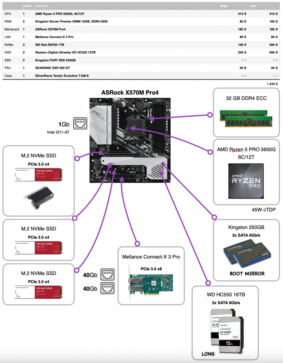

I am wrapping up my final hardware choice to update my TrueNAS Scale System.
I went through the official hardware recommendation list - but would like to go with an AMD system because of a mix of price, power consumption, performance, form-factor and current local availability.
Additional components:
  • PSU: SEASONIC SSP-350 GT
  • CASE: SilverStone Temjin Evolution TJ08-E
  • CPU-FAN: Noctua NH-L9a-AM4 chromax.black
Storage setup:
Boot -> 2x Kingston FURY SSD 240GB (Mirror)
Fast Storage -> 3x WD Red SN700 1TB (RaidZ-1)
Archive -> 2x Western Digital Ultrastar DC HC520 12TB (Mirror)
Any issues or things I might forgot?
I know the boot mirror is overkill - but I still have those drives laying around for free. Also the case is already there and thats why I like to go with mATX.

Now the only question left is regarding the „ASRock X570M Pro4“ PCIe Lane supply given an „AMD Ryzen 5 PRO 5650G, 6C/12T“ CPU installed.
The CPU has 24x PCIe 3.0 (16+4+4) and I plan to utilise the iGPU for server setup and occasional local maintenance. I did read they is maybe also important when it comes to available lane count.
Now on the motherboard I have the following PCIe components planned:
PCIE1 x16 (set via BIOS as x4x4x4x4*)
  • ASRock Hyper Quad M.2 Card with
    • M.2 NVMe SSD (PCIe 3.0 x4)
PCIE3 x16 (@ x4 speed)
  • Mellanox ConnectX-3 Pro (PCIe 3.0 x8)
So both PCIe Slots account for a total of 20 lanes used coming from the CPU which in theory should be feasible according to the specification „…dual at x16 (PCIE1) / x4 (PCIE3)“. The Mellanox card also supports auto negotiate so should be fine to run electrically at x4 lanes in a mechanical x16 slot.
Now additionally I would like to use the M.2 slots on the motherboard:
M2_1 (@ x4 speed)
M2_2 (@ x4 speed)
… and also 2x SATA3 6.0 Gb/s connectors
SATA3_1 (@ 6.0 Gb/s)
  • 12 TB HDD (SATA3)
SATA3_2 (@ 6.0 Gb/s)
  • 12 TB HDD (SATA3)
Is that setup valid? Do I run out of PCIe lanes or are some throttled down? It would be ok if the 2x M.2 NVMe on the motherboard are not at full speed / with less lanes.
*x4x4x4x4 PCIe bifurcation was added with later BIOS update
I also posted this question directly to ASRock ... let's see if they can supply an answer ...

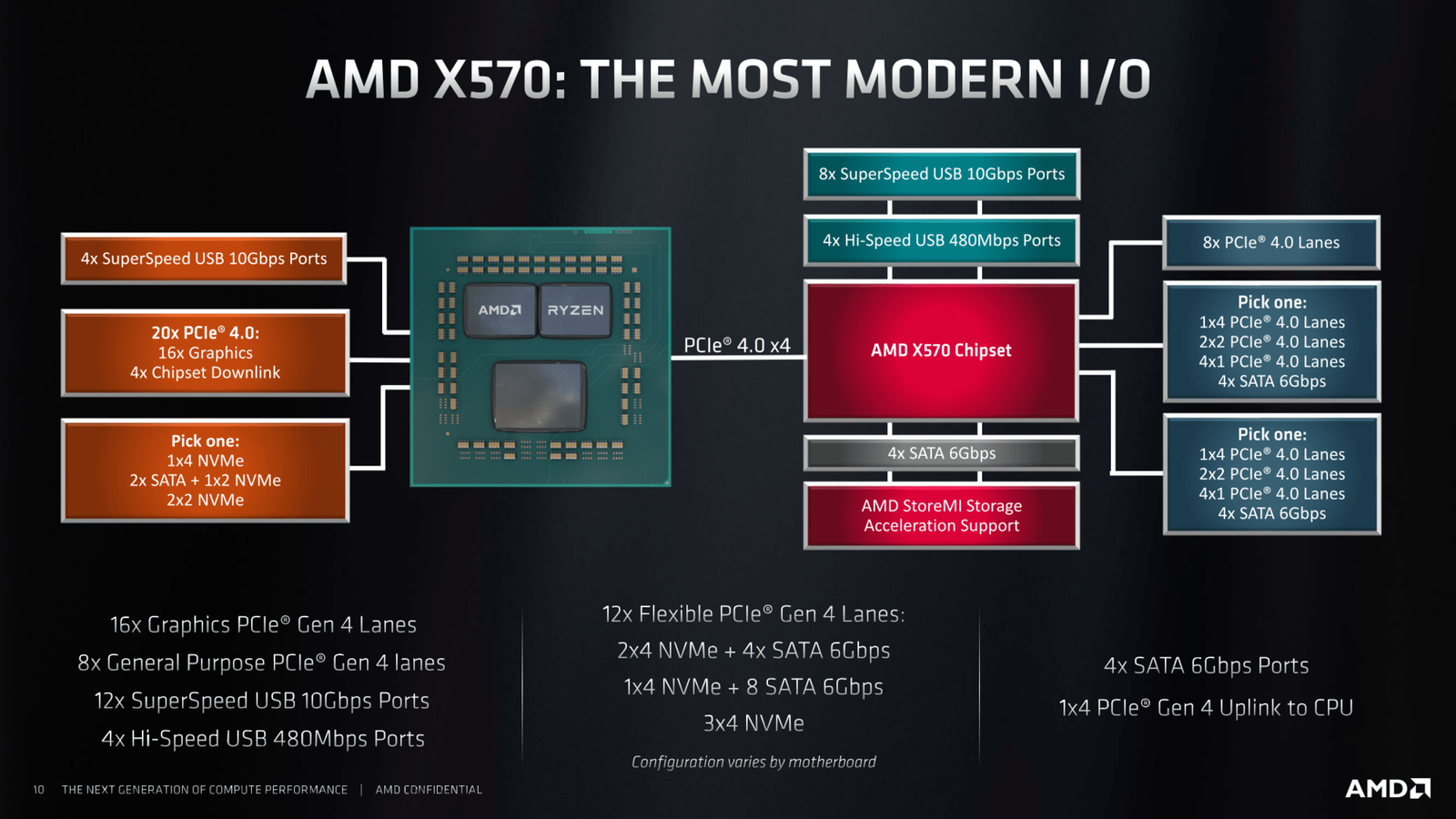

Ah ok … according to the I/O diagram the chipset actually has a quite sizeable amount of extra PCIe lanes… so it should actually work!

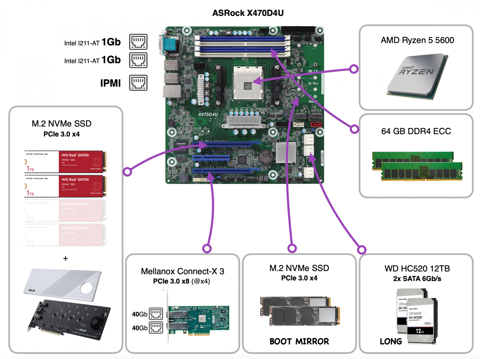

An update regarding AMD AM4 Generation support.
So I initially tried the combination of an "ASRock X570M Pro4“ Motherboard with „AMD Ryzen 5 PRO 5650G (Cezanne)". Unfortunately after some troubleshooting and contact with ASRock support the AMD AM4 CPUs with iGPU/APU do not support x4x4x4x4 bifurcation on any ASRock motherboards:
I have tested it with BIOS 3.71, and it is not BIOS related, but CPU related.
I used a 4750G (Renoir) CPU, and have indeed the same options that you have, only a PCIE x8 slot
Then I retested with a 5900X (Vermeer) CPU, and then you have a PCIE x16 option, as you can see in the attached screenshot, these CPU's allow 4x4 Bifurcation
My next idea was to go with an ASRock Rack board but same issue:
ASRock Rack has their own support.
I had a chance to test this board, with a Cezanne CPU and a Vermeer
I made a screenshot with the Cezanne CPU, also this board, do not support 4x4, with this CPU, only x16, or x8 x8, or x8 x4 x4
With a Vermeer CPU, it can handle 4x4 as well, I also tested that
It is not board related, it is a limitation of the CPU.
So if I want to go with the ASUS HyperCard and 4x NVMe drives (x4x4x4x4) I have to use an AMD CPU without iGPU/APU.
So my current path is to update the config to use an "ASRock Rack X470D4U" and "AMD Ryzen 5 5600" because the X470D4U has onboard GPU and can run the 5600 headless as confirmed by support:
Yes, this board has onboard graphics, so you don't need a graphics card, or APU
Actually the term onboard is not correct, when it comes to Desktop boards, because there is no graphics chip onboard anymore.
But this board does have onboard graphics.
