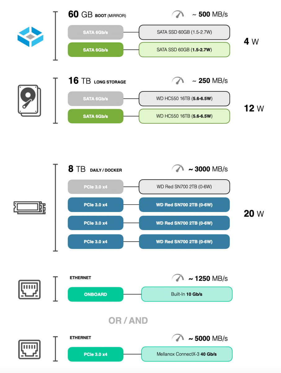

... as well as a proper M2 NVMe Storage pool (RAIDZ-1). For that ideally a mainboard supporting proper bifurcation (4x4x4x4x) on a x16 pcie slot would be necessary. Then I could plug in up to four cooled M2.NVMe cards in one M.2 Adapter Card (ASUS Hyper M.2 x16 Gen 4-Karte or ASRock Hyper Quad M.2 Card).
See planned drive layout:
Ideally idle power consumption for this 24/7 setup should be around 50 W or better below. Load should ideally not exceed 70-80 W. GPU not required.

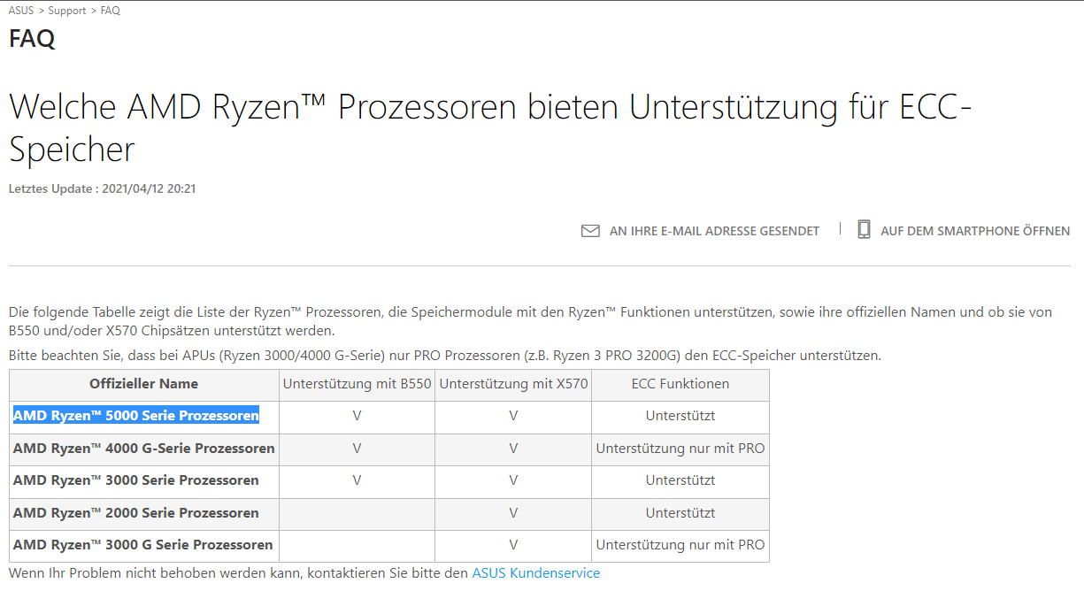

Ah ok ... according to ASUS the Ryzen 5000 series also "officially" supports ECC - not depending on the "PRO":
*5000 series supported without explicit mentioning of PRO requirement.
So in comparison:
AMD Ryzen 5 5600
+ 24x PCIe 4.0 (16+4+4)
- No Remote Control via DMTF DASH
+ 190€
AMD Ryzen 5 PRO 5650G
- 24x PCIe 3.0 (16+4+4)
+ Remote Control via DMTF DASH
- 240€
... also the PRO version has TDP-down .. but the "normal" version can potentially be underclocked?
The PCIe4 version of the 5600 would allow to utilize the full speed of the NVMe SSD as well as the 40GbE more easily.
