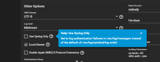

What happens if this box is checked?
tyler.montney
Apr 27, 2021
33
Doesn't break anything and I see logs under /var/log/samba4. Unfortunately, none of them seem to log connections. Perhaps increasing "Log Level" will help?
