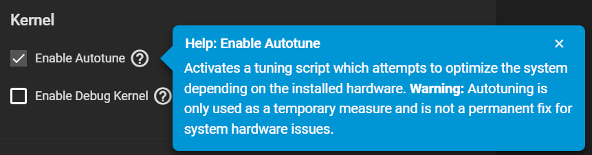

There's one more thing to try on the TrueNAS server: Under System->Advanced, enable autotune and reboot. This sets several memory tunables that may prevent the RAM consumption you've seen during the disk imports. It's worth a shot.
I have enabled it:
But unfortunately I still experience the same behaviour where all my RAM gets used by Services. Should I disable Autotune?
