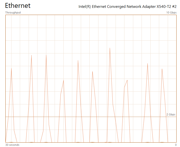

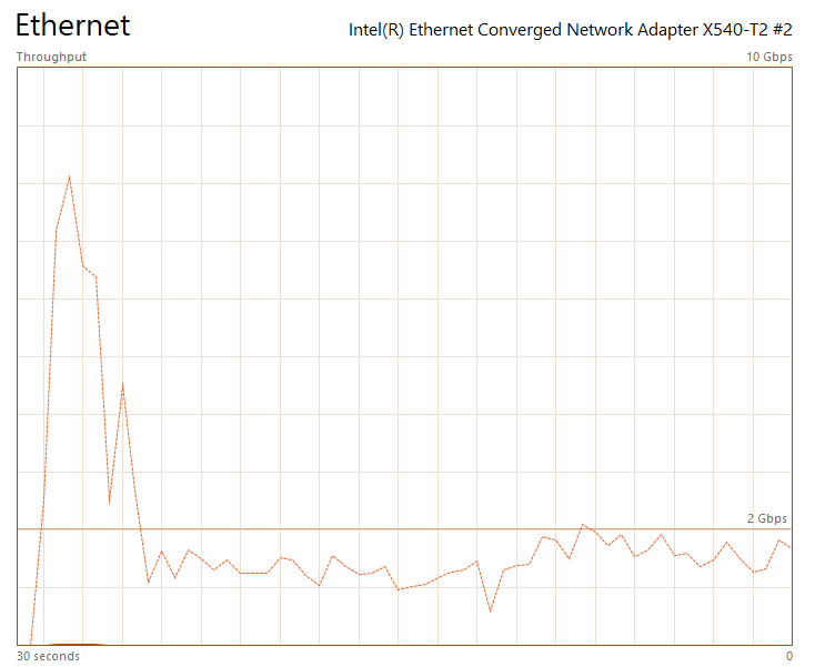

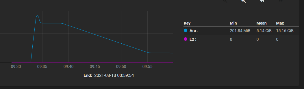

Just like in the title, and the accompanying graphs, shorty after boot, the wired memory goes way down, the services go way up to almost all of my memory and stay there.
If I transfer a large file immediately after boot, before the wired memory goes down, I get very consistent, steady, normal network usage in windows task manager and very acceptable transfer speeds. But after the wired memory goes down and the services reach 20 gigs, I get very strange saw-tooth networking use, and slower transfer speeds.
(see both windows task manager screenshots)

Ok, I'll leave this up if anyone has a similar problem, but deactivating " ballooning device " in the VM hardware RAM setting for the TrueNas VM inside Proxmox seems to have fixed this issue.
It looks like Proxmox was trying to get some ram back and TrueNas really doesn't like that.
