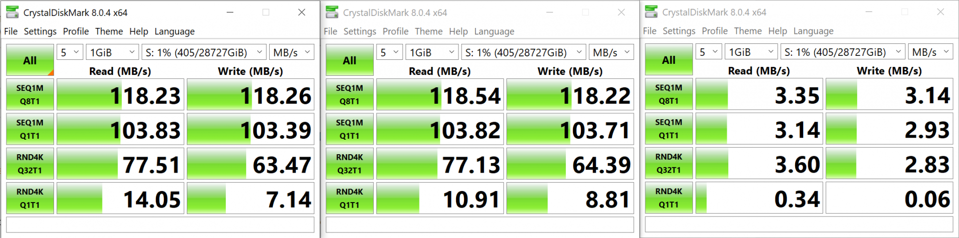

CrystalDiskMark benchmark - Left locally wired through network, Right via isolated connection

Today, I did a trace on all the ports, moved everything to a different gigabit switch and was successfully getting gigabit speeds through the switch and also through the router, testing both through iperf and CrystalDiskMark. So now I know I'm getting gigabit speeds to and through the router.

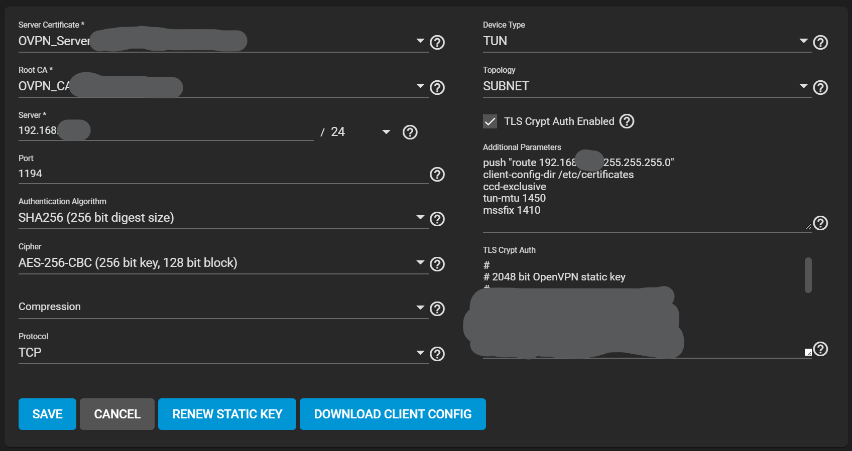

Reviewing the link. Tried the connection over the VPN both before I did the experimentation about and after. Speeds are marginally faster, but nothing blazing fast, at both 1470 and 1450 MTU, and also with mssfix 1410 (at MTU 1450). At this point it's leading me to a configuration issue with OpenVPN.
L - Speed over wired LAN, TN system on switch, PC on Switch.
M - Speed over wired LAN, TN system on switch, PC on router, router to switch.
R - Speed over VPN (from my house with Gigabit internet ~5 miles away from install site.
Current OpenVPN config in TrueNAS.
I did have it running UDP at one point weeks ago, but that for some reason started to never connect, and I also was getting poor speeds through it.
client
dev tun
proto tcp
port 1194
remote "redacted"
user nobody
group nobody
persist-key
persist-tun
tun-mtu 1450
mssfix 1410
**keys redacted**
verb 3
remote-cert-tls server
auth SHA256
cipher AES-256-CBC
**tls crypt redacted**
