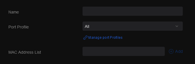

All without effect. The switch in use is a unify 24p Gen 2.
The port has default config. No VLAN configured:
9,703
