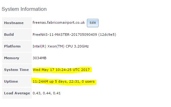

Thank you, I've been after that command for ages!!.
it seems to have gone through ok, it says "System Time" is an hour behind but the "Uptime" is correct, i assume the System is the one i need right??
I'll take a look through the links thank you :smile:.
Now you should check your time zone. It has to be the same as on your DC.
Uptime is only the information how long your freenas box is already running.
If you restart your server, it will get back to 0.

Bingo!!!!!!! I can see the domain group users and groups now. Time was the issue, i just couldn't get it to sync, tried all sorts!!!
I only see them when I change permissions on a share though from the drop down, so i have to manually type them in. I think I've read that somewhere this was the case though.
