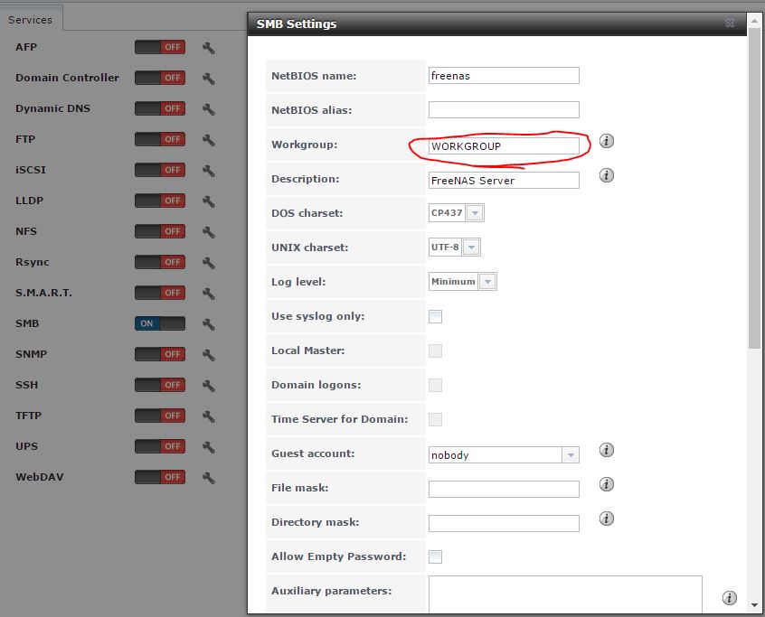

  • SMB won't let me change the Workgroup to my domain, says the NETBIOS name is not valid, either though it's right!!!

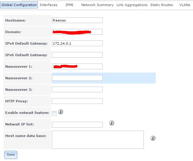

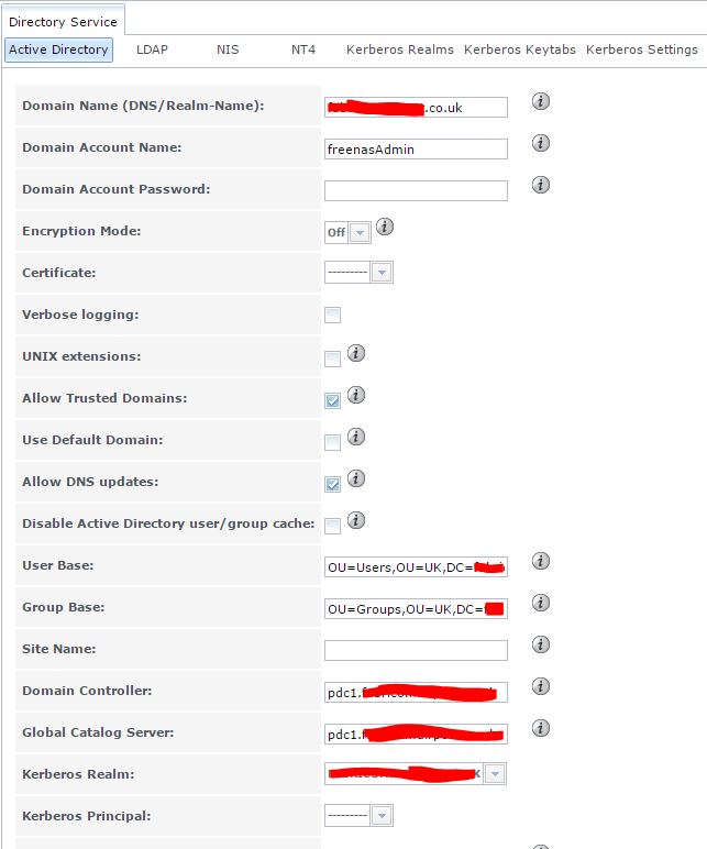

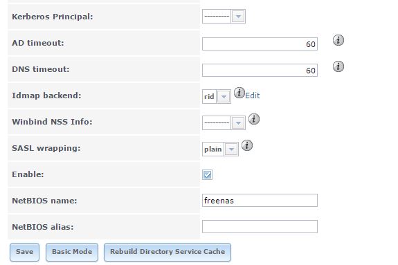

Pictures attached, any help will be appreciated :) :).

Turn off SMB. Fill out only the following items under "Directory Services" -> "AD"
  • Domain Name [foo.com]
  • Domain Account Name [name of member of domain admins]
  • Domain Account Password
  • NetBIOS Name [name of your server]
Before doing this, verify that:
Time on FreeNAS server and DC is same
Hostname, Domain Name, and Nameservers are properly set under "Network" -> "Global Configuration".

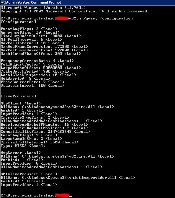

NTP server prep
  • From a CMD prompt, type w32tm /query /configuration - if NtpServer shows time.windows.com- you should really think about changing it.
    • To change the time server to both use a more accurate clock, and redundant clocks, type the following:
      • w32tm /config /syncfromflags:manual /manualpeerlist:"0.us.pool.ntp.org,0x1 1.us.pool.ntp.org,0x1 2.us.pool.ntp.org,0x1" /update /reliable:yes
      • If you got any result other then "The command completed successfully", verify your command line. View an example successful result HERE.
      • Restart the Windows time service by issuing the following command net stop w32time && net start w32time. View an example successful restart HERE.

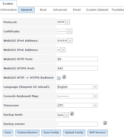

Are these the commands to be used on the Windows DC or the FreeNAS server??
I saw these commands before and they didn't work on the FreeNAS "Shell" option.
I've set my FreeNAS to look at our DC for a NTP server already but it's 3 minutes out.
Also I don't the option at the "Active Directory option at the bottom to select, see attached.
Regards
James

Since that post was made the active directory area moved, however, the commands in the top quote are to be run on the DC itself in order to allow FreeNAS to connect to it.
