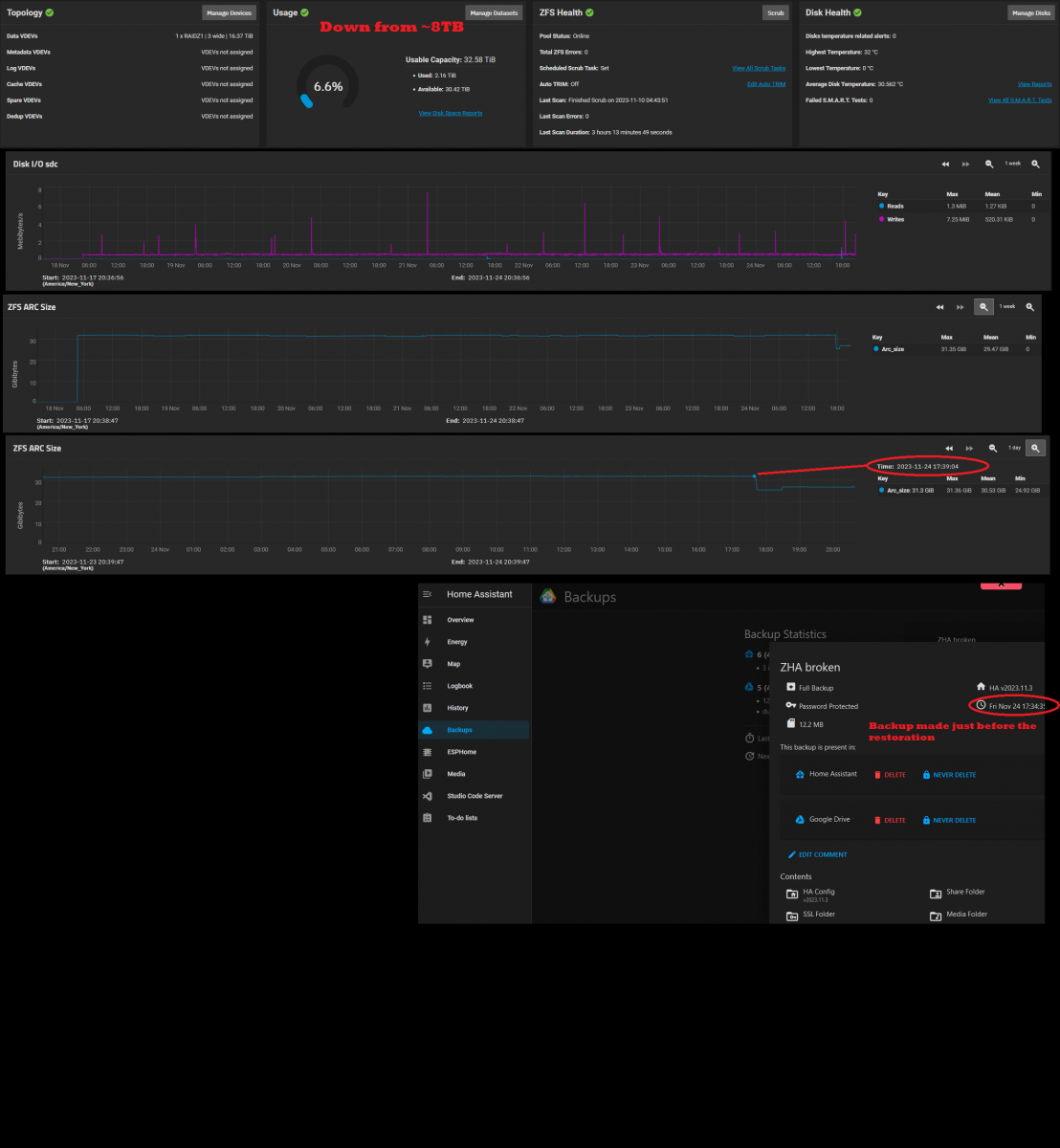

I went through the available history within TrueNAS and only found one unusual blip over the past week. It coincided with another unique event on my network. Attached is the correlation of the ZFS ARC size dropping moments after I created an Home Assistant backup before initiating the a HA Restoration - something I had never done before, on a device I've only had a few days. The HA device had privilage to delete the "media" dataset because I was being lazy and reckless. Can anyone confirm this is sufficient information to determine root cause? No other dataset on my TrueNAS sees anywhere near as much use as the "media" dataset, so it's practically the only thing represented in these logs.
With root cause likely closed, can anyone help me 'un-delete' these files without access to a snapshot, or let me know that's entirely impossible? I'm hesitant to spend the next couple of weeks restoring the backup if the data is there with just a few bits toggled to indicate they're ready to be written over... This dataset is not encrypted.
