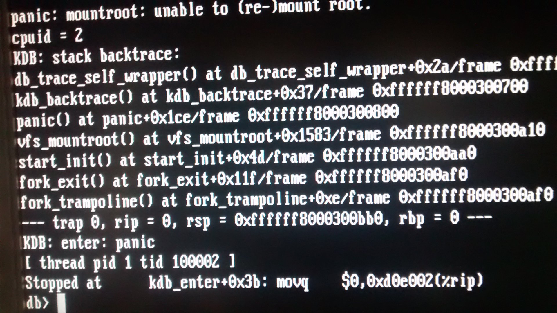

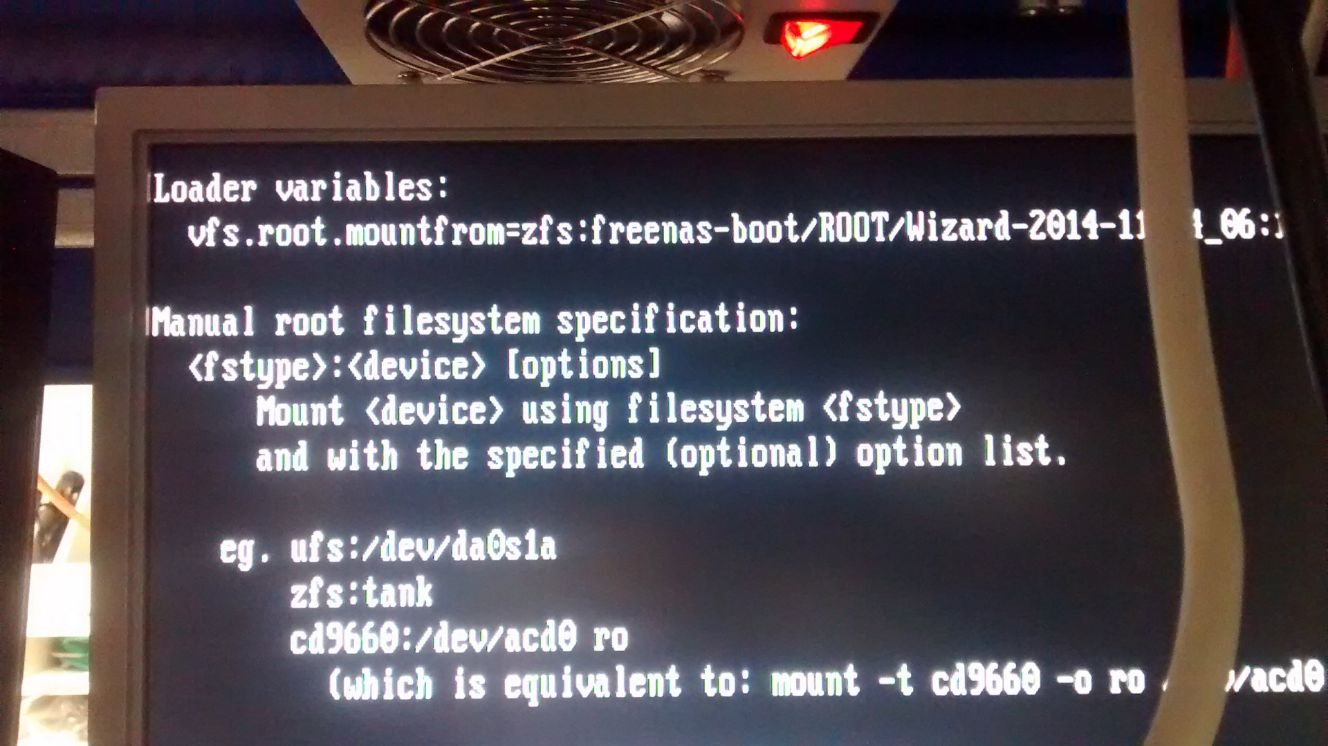

* did a fresh install from the first 9.3 beta ISO --> everything OK
* then did upgrade pending packages from within webGUI
* reboot
* kernel panic because could not re-mount root filesystem (boot media is an usb-stick)
* selecting the first boot entry (9.3 beta) in grub boot menu in order to revert to last working version did work
see screenshots for details

jkh
Guest
I've never seen anything like that before. Does it panic again if you re-select the boot environment that had the problem? The fact that it can boot OK from the same pool, but not liking a specific dataset (clone) is definitely odd. As I said, that's a totally new one on us.
