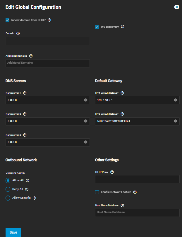

i got this error when trying to update freenas scale "451, message='', url=URL('https://update.freenas.org/scale/trains.json'): Automatic update check failed. Please check system network settings."
I tried almost everything.
The 451 error means Unavailable For Legal Reasons but since i live in Belgium that should be an issue? (ISP: Telenet)
