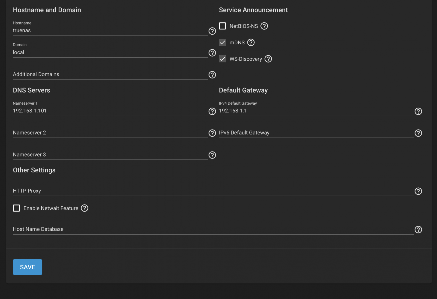

After changing my network global config to the pic above, i get the following error:
451, message='', url=URL('https://update.freenas.org/scale/trains.json'): Automatic update check failed. Please check system network settings.
Hi, I was having this issue and was getting the same exact error. I went into the Network/Global Configuration and changed the Nameserver1 to the same IP address as my Default Gateway. This fixed my problem. In your case, change it to 192.168.1.1 if this is really your Default Gateway IP address. Good luck!
I had exactly the same problem. It turned out that I had an IP address typo on the NameServer1. After fixing it, everything started to work as expected.
