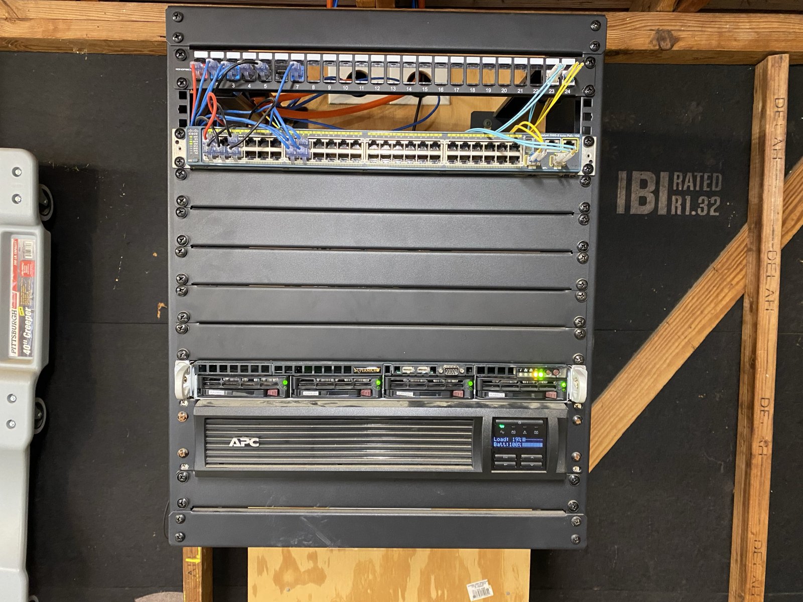

The idea here is to replicate my backups to this NAS as its physically about 150ft away. Networking to the garage is fiber, so lightning can't come through an AP or Camera outside and into the switch and nuke it, and its quite well separated electrically too being in a different building on a separate UPS, and much closer to ground. Right now my long term local backups (not my only backups) are in the same rack which has problems
  • Roof leak over the rack could damage both original and backups
  • 80ft Water Oak could smash into the house, and crush both
  • Physical theft, if they steal the rack in the house, its not likely they steal all the junk in my garage rack
  • Lightning strike through a switch could kill both, not now
  • UPS could nuke both, not now
There is a LOT of benefit to replicating backups to a different location on your property, even if it is in a more harsh environment. The odds of losing this entire array is low, and even if I do, the snapshots can be re-replicated as they are stored for the full retention in the main NAS as well as secondary. The odds of me losing my primary array AND this, are extremely slim. The entire purpose of this copy is to prevent physical damage
It also moves heat outside the house, which is a plus

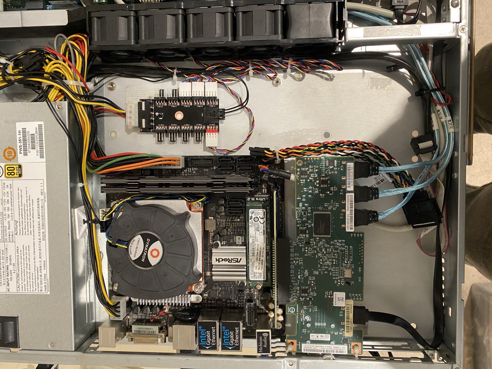

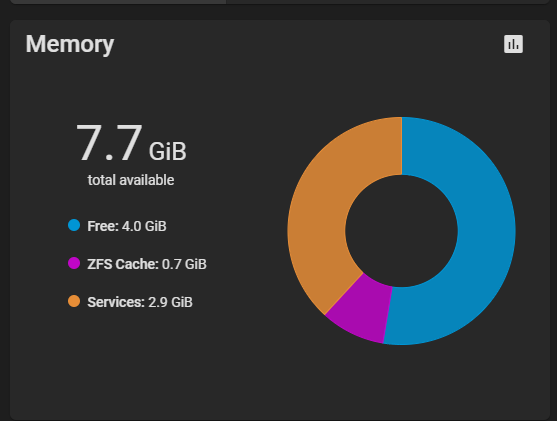

Some shots of the system. So far its performing very well. RAM is not even CLOSE to being an issue with 3TB replicated so far. CPU load is minimal, 10% at most

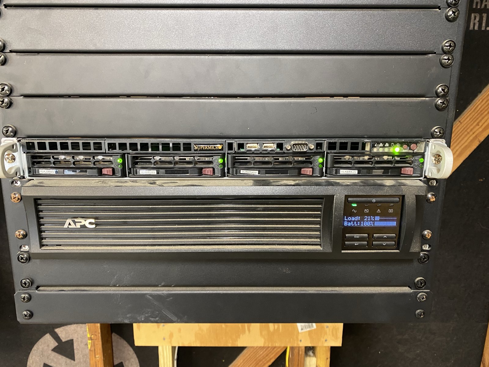

Ignore the marks on the UPS/Rack, thats where a Raccoon tried to climb up it

I might buy the 5th fan for the chassis though, that will blow right across the HBA heatsink
