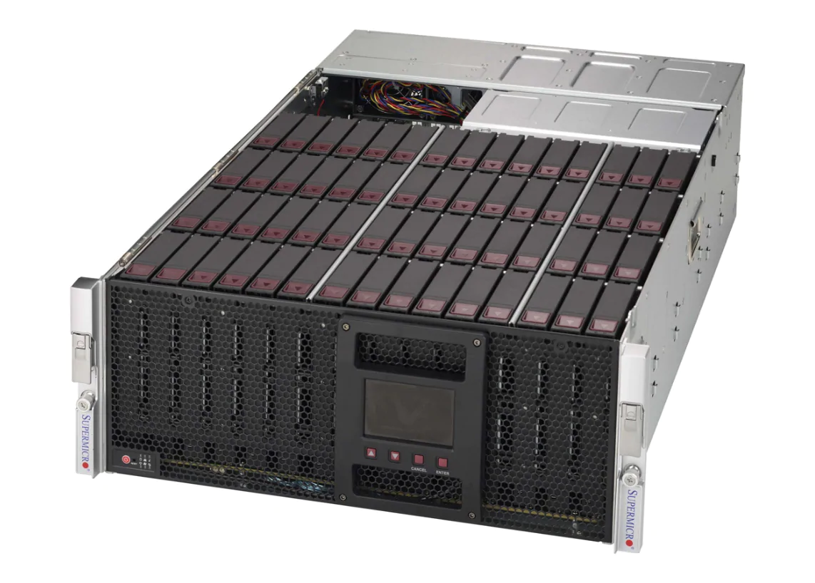

Take a look at this 60 drive system:
24 drives is just not enough...
