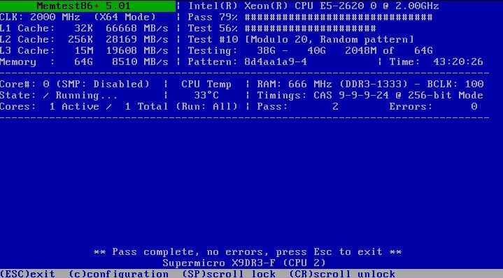

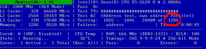

Almost two day test for the initial 64GB that shipped with the box. Just installed the other 64GB and testing that now.

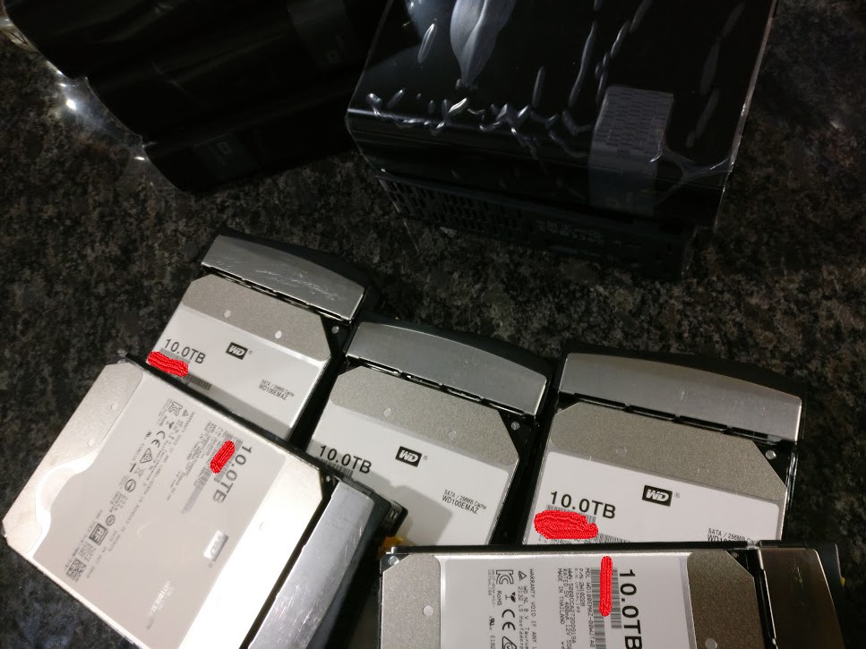

Bought 10, 10TB EasyStore external hard drives and shucked them. I got five of them today and installed. I'll get the other five on Monday. Then I get four SSDs on Friday for the OS and Jails.

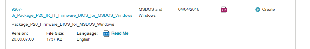

Chris, was I wrong to assume P20 meant firmware version 20? Kinda liked the idea of not having to deal with flashing this thing but it came with FW version 15.10.01.00 instead.
It may be a problem with the vendor. If you didn't get a card that was already updated to the correct firmware version, you can update it yourself, or send it back for a refund. I don't have any control over what a vendor on eBay actually ships vs what they advertise. I have been burned a few times myself. Just today I got a box of ten hard drives that were supposed to be Seagate but turned out to be HGST, so I filed a claim and turned them around to go back where they came from.
The firmware needs to be IT mode Firmware version: 20.00.07.00 ... The sub version 07 is important because there were some problems with previous versions when working with ZFS.
